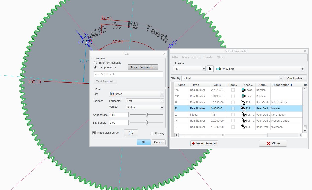

I would like to add a text on my gear (solid part) using data from my parameters.
Normally I would write: "Mod &m, &z teeth" refering to my parameters with the "&".
Sadly the text line does not accept this.
Any suggestions?

You could use a relation to generate a string parameter, converting the numbers to strings within it.
I think it would be something like:
label = "Mod " + itos(m) + ", " + itos(z) + " teeth"
and then choose the 'label' parameter for your text, as already shown.
This gets a little more tricky if m is not an integer - this has been covered elsewhere though.

Hi, split the note up into 4 elements within the one feature. First bit, would be manually entered text "mod", constrain/dimension it, next bit would be use parameter, select your parameter "M", constrain/dimension it, relative to the "mod" text. Repeat the procedure, for number of teeth text. Hopefully, this makes sense to you.
Hopefully, i have understood your problem.
John

It makes sense, I was just hoping there would be an easier way..
for example, is there a way to make a new parameter which contains the combined text and use this?
August 23, 2013
How about you make the value of a single parameter read (string) "mod 3 118 teeth". Not quite ideal, but its a work around.

August 23, 2013
Works like a charm, thanx!

Note: You can also string together string parameters as well, like this:
PART_NUMBER = DRAWING_NUMBER + DASH_NO
NOMENCLATURE = DESCRIPTION1 + SPACE + SIZE
MATERIAL = ASMSPEC1 + SPACE + ASMSPEC2
So, I'm sure you can also string together any combination of integer and string parameters to get what you want.
