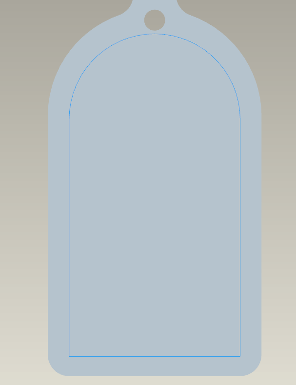

Hi All,
I am trying to create a label where I have several lines of text. I would like this to be viewable on the 3d model. In the past I would just add it via cosmetic sketch or just a sketch. The problem is each line is seperate. Ideally I would like to have it in a sketched off area where I could just type in the text & it automatically fit. Doesd anyone have any ideas or suggestions?
Mike

Hi Kevin,
Thanks for the reply.
Basically i just want to put multiline text in a specific area. I have attached a picture. I would like to fill the sketched area with text. I know you can create a sketch or cosmetic sketch & create individual lines but that is not what I want.
January 7, 2011
Mike,
I now understand what you want you want to do, and unfortunately, I don't know that there is a quick way to do it.
Do you have another software that could easily do what you want and export the multiline text as an IGES or DXF file, each of which can be imported into Pro/E and traced?
Kevin
January 7, 2011
Mike,
Unfortunately multiline sketcher text does not exist in Pro/ENGINEER. And everything else imported as a DWG or other would come in as individual vectors.
You would just have to insert multiple lines of sketcher text into your sketch and adjust each line for justification.
You can use various true type fonts though that was not available a ways back .
David
January 12, 2011
Thanks for your help. I have just put it in single lines.
