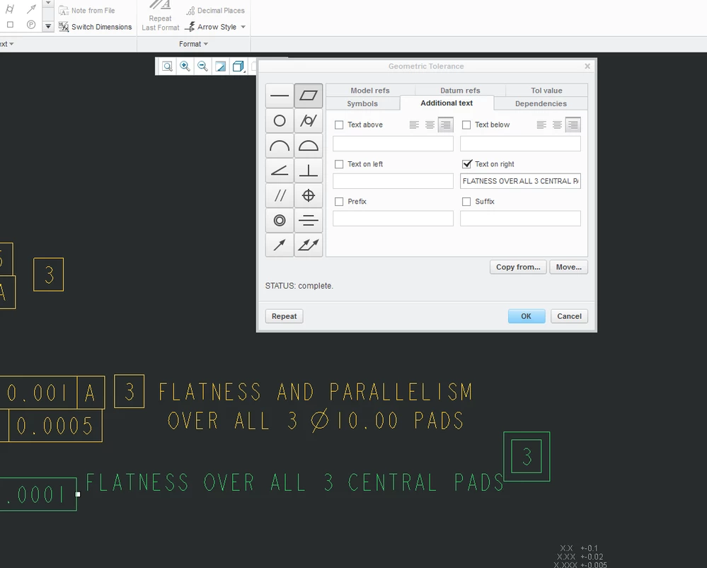

I am trying to add a box around the text i add in geometric tolerancing.  Is there any way to do this?  Usually we will reference a note in our note callouts.  Note #2 for example in the notes, has a box around the number.  i am trying to add a box in the additional text on the Geometric tolerance, but i dont have that option that i can see.  Without having to use an unattached note, is there anything else i can do?
Thanks for your help

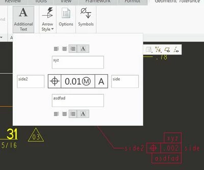

On Creo 4 M070, I can add additional text and the "box" option is available on the above or .
If this is not what  you are looking for, do you have an example of what you are trying to accomplish?

thank you for that.  we are on Creo 3.  that isnt an option on my Gtol options.
i have to create an attached note to attach it.
in this example, the 3, is just a note, that i had to give an attachment to the gtol.

Ah yes, I see. It still doesn't look like Creo 4 will solve that. Only above and below has the box option and then it's an all or nothing deal Just specific text within the box can not be individually boxed in (even using the
@[ @] notation.
