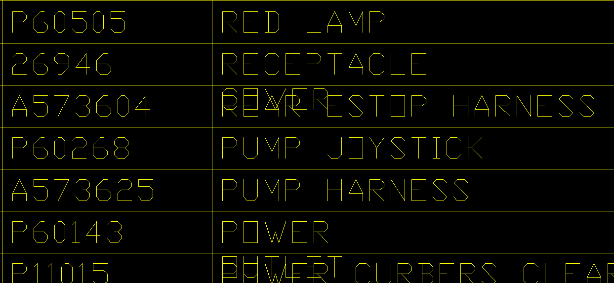

we export the drawings into autocad (using autocad LT/2009).
in some bills, the text is shortened and stacked, with the stacked portion appearing over the item below it. this behavior is random. sometimes long text is modified, sometimes short text is. only appears when the export is done, not on the original creo drawing. the text appears as Mtext in Autocad. creo is set to dwg_export_format is 14,intf2d_out_stroke_text is none,
this only happens when the drawing is exported to autocad. no issues when exported to pdf.
