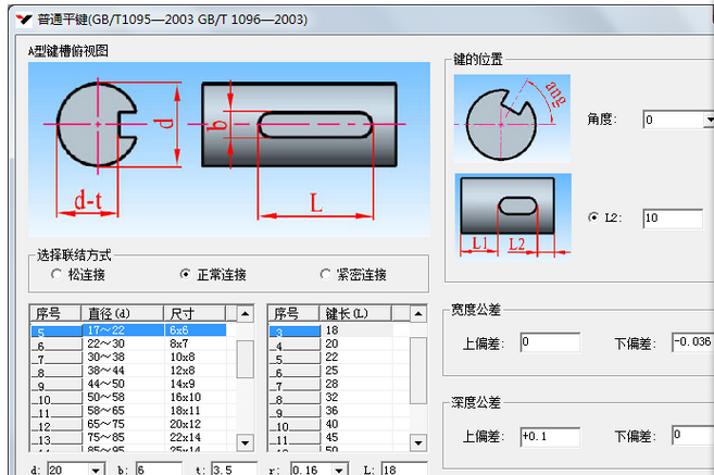

3.connectors/equipment/udfs
If we add axis  profiles to profiles file ,we must add axis features (Keyway,Center hole,Retaining ring groove,and so on)
