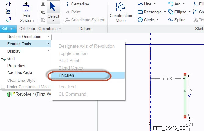

I have been looking but not finding an answer. I am trying to start a sheetmetal part with a revolve but I want to dimension to the ID in one section of the revolve, have a small offset and then dimension to the OD of the second section. In WF4 I can thicken while sketching and create these two dimensions. When in Creo 2.0 and while sketching my revolve section I can not select thicken (setup-feature tools-thicken) because it is grayed out. If I create a second (unattached) revolve section after my initial revolve I can thicken it because this feature is not grayed out. Why does Creo allow the use of thicken in a second revolve but not in the initial feature of a revolve sketch?

Eric,
This was an issue till Creo 2.0 M090 and corrected in M100. Check attached image

Eric,

Thank you. I will work on upgrading.
