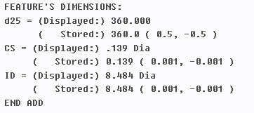

A couple of longshot possibilities.
1. Does this model have a merge feature or inheritance feature? The new part won't let you create a 'c' if the merge part had a 'c'. There is an easy workaround by renaming the c in the original part to anything else, then changing it in your part to c, then renaming it back to c in the original.
2. Go to TOOLS, MODEL INTENT, PROGRAM, SHOW DESIGN and then scroll thru that and see if you come across something that uses 'c'.  Maybe something like below. Hopefully it's not a massive model, since you can't reasonably search for the letter 'c'

Thank you for responding, Stephen.  That tip about "Show Design" was really neat and I had never known about that feature.  I can see how it could be useful in the future but, sadly, it didn't locate the mysterious "C" dimension that I can't seem to find.  Oh, and yes, an external inheritance feature is used but no "C" is used in their either.  I believe the "C" dimensioned used in the family table is related to some cuts that happen in the part file in which I'm working.  I am going to see if I can upload the part...
