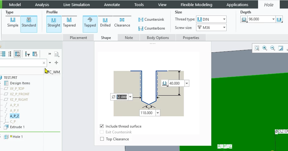

Hello everyone,
I have a question regarding the representation of partial threads in Creo Parametric. There, only a single surface is created for the thread surface together with the hole, which makes it impossible to colour the surface of the thread. We use the following creation method for a partial thread:
We like to use colouring to visually show how deep the threads should be cut.

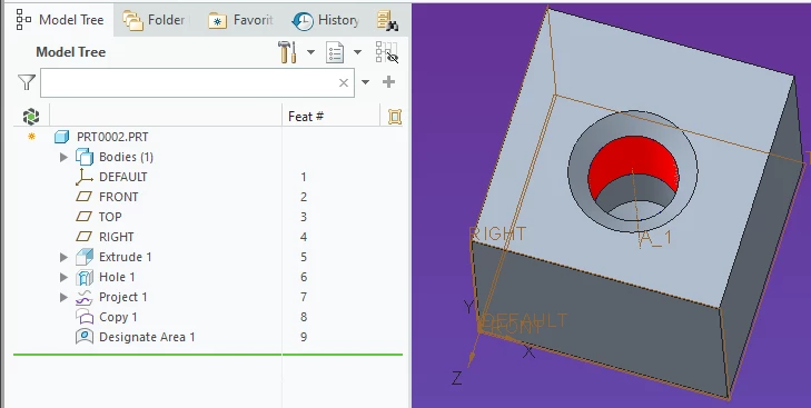

Not an elegant solution, but you can use Designate to paint the appropriate area.
  • Project the bottom of the cosmetic thread.
  • Copy the top edge of the hole.
  • Create a designated surface area using the bounding curves created.
  • Apply color to the designated surface.
7-Bedrock
Jun 2, 2026 12:37 PM UTC
So what I noticed now is that Creo is creating invisible, but selectable edges with the creation of a tapped partially threaded hole:
So I used these edges to divide my cylindrical surface:
This works, but is a really complex way...
