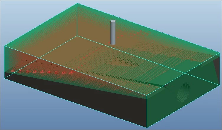

i import one part and did drill inside by selecting the axis after i need to bore the hole at 50 mm starting point then i need to do thread mill on to the part that leave portion but it was telling to select the axis and while take my arrow to the axis it was not going to select
please any one knows tell me how to do threading and boaring operation in part
see the part and asm model
Best answer by ptc-4392950
i can't seem to open your assembly becaue the "workpiece" is not available.
but are you using the correct Coordinate System for your sequence? so that Z is pointing like your hole axis.

dear arno thanks for replying me i got the answer but will you help me to give answer to another question and my question is
