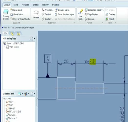

Tolerance overlapping when add tolerance dimension (plus/minus) in the drawing part. How to fix it? Thanks.
I attached with an example of issue.

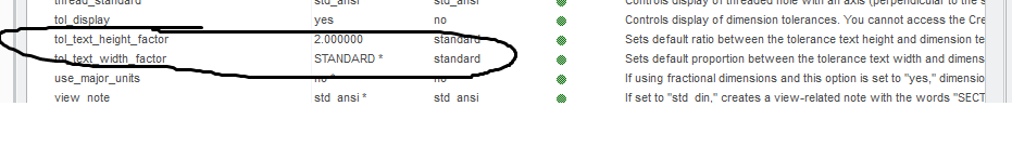

Height and width of the tolerance text are controlle by the following two drawing setup file options.
TOL_TEXT_HEIGHT_FACTOR
TOL_TEXT_WIDTH_FACTOR

I did following set up to TOL_TEXT_HEIGHT_FACTOR and TOL_TEXT_WIDTH_FACTOR .
The text height and width factor change on a line. but, the tolerance plus and minus (2 line) still overlap.
please advise. Thanks
