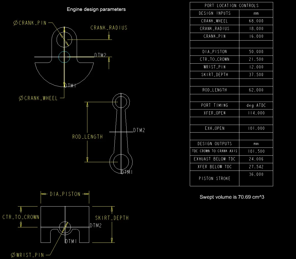

Layouts created using Notebook functionality are capable of driving design from a top level data set in the .lay file. You can declare the layout to parts and then use the parameters and relations from the layout to drive multiple children. The layout will allow for the creation of global parameters that can then be passed to multiple children to control common design intent across models. Once the layout exists you can declare it to a model and then all design intent in the layout is available for use in the model(s) you declare it to.
PTC has not really added much to this tool since it was first offered and I think they intend to use Mathcad to replace the layout tool in Creo. It is very useful but the interface/setup has not evolved. You will need to import graphical data as DXF and then create the parameters and relations needed in the layout to control your part models as intended. You can at any time decide to undeclare the layout so that it is not driving a model if you need to.
As long as you can write equations that capture your design intent then the layout should work for you but it will require up front planning and development.
The enclosed picture is an example of a layout used to design and control the geometry of the individual components of a 2 stroke internal combustion engine. The input parameters are entered in the layout and relations are used to compute the correct values needed to create the geometry that will realize the desired parameters in the individual parts.

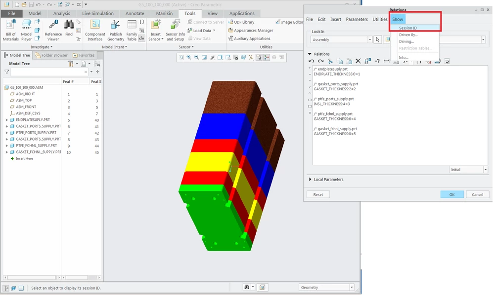

February 21, 2019
please see attached data_set.zip.
I added following relations into g5_100_100_000.asm
/* endplatesuply.prt
ENDPLATE_THICKNESS:0=1
/* gasket_ports_supply.prt
GASKET_THICKNESS:2=2
/* ptfe_ports_supply.prt
INSL_THICKNESS:4=3
/* ptfe_fchnl_supply.prt
GASKET_THICKNESS:6=4
/* gasket_fchnl_supply.prt
GASKET_THICKNESS:8=5
Regenerated assembly is shown in following picture.
Command Show > Session ID enables you to get IDs of individual parts.

YES,  you have to specify the command over and over using the respective session ID's in case that you want to drive component thickness using top assembly relations.
