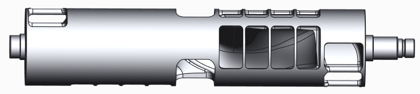

I want to simulate an air plug which makes the distribution in a motor.
This plug is in the cylinder head and two bearings at each end hold it in place.
Thanks to a chain on a sprocket at one end, the part rotates at 4000 rpm. So I add a centrifugal load on the whole part.
The chain does not rotate everytimes at the same speed and due to the inertia of the part, the chain creates a torque at one end of the part.Capture.PNG
I put two pin constraints and two planar constraints at each end to simulate the bearing and I add the torque on the right end (460 Nm).
But I need to block the last degree of freedom (the rotation on the central axle of the part) otherwise I can not do a simulation...
I don't know what to block because in the reality the part is not blocked...
Can you please help me ?
Jordan
June 25, 2014
If I understand this correctly, the component isn't transmitting any torque - it's just being twisted against its own inertia, presumably backwards and forwards at some fairly high frequency.
If you look at the centrifugal load it also has a section for angular acceleration. If you replace your torque load with a rotational constraint, and instead apply an acceleration load, does that do what you want?

you write: "due to the inertia of the part, the chain creates a torque at one end of the part"
It is only true during acceleration/deceleration.
At fixed velocity, one doesn't care about inertia of the part.
During constant-speed rotation, the motor torque will be due to frictions or a torque load applied on this part.
In theory, if you apply a constant torque on a part that is frictionless, it will endlessly accelerate.
