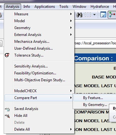

Does anyone know of a tool (or even method) to track changes in
Pro/E? Similar to the way that Microsoft word would track changes? We
update drawings through shared models, but we need to document each and
every change throughout the process. Our completed drawings are correct
since we all use the same model, but the exact details are missing from
our change notices.
Thanks for any ideas you may have come across. Have a great day.
July 13, 2010
Try using a Compare Part report in Pro/E.
Analysis -> Compare Part -> By Feature...
You'll then need to be sure to turn on show all versions in the file selector and pull the prior version you want the differences to.
