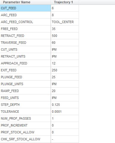

Michael,
I had the same problem. What I found is If you look at the parameters there are three feeds that are for what appears to be the plunge. They are approach, Plunge, and Ramp. I have been setting all three with the same approach or plunge feed and it seems to behave itself when plunging. I haven't had time lately to test to see what each does so that is my solution for now maybe someone else knows what the difference is.

Michael,
I don't think it's a modal thing or in the post. I think it's PTC giving us more control over feeds and tool path. I view that as a good thing for us! It allows us to control how the tool enters the path by slowing it down if we are plunging into material or at a more rapid feed if it plunges in air. So I like it, but it takes some getting used to if you are coming from WF3 or 4 where you only have the plunge feed so ramps approaches and plunges all ran at the same speed. You could set the 3 feeds to a standard feed rate in a site file if you wanted so that it would always be set if you don't like them at a fast rate.

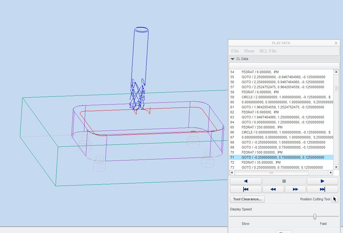

July 23, 2012
Michael,
I finally had a chance to actually test feed and rapids for trajectory milling. What I did was create a trajectory sequence then fill in the parameters with various feed numbers then do a play path with the CL data visible. If you try this it shows you what all the different feeds and rapids are.
If you try this with different ramps and leadin leadouts it shows you how everything works pretty well
Steve
