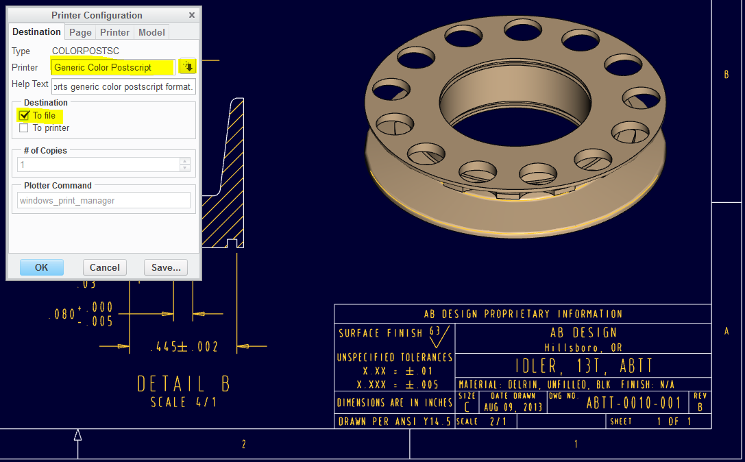

Welcome to the forum, Burhan.
Every time we discuss printing I learn something new.
I recommend the generic color postscript setting in the print dialog.
A few caveats: 1; this will plot lines in the color of the screen. if you don't want this, you need a pen table. 2; If you scale the output, it will not scale the pen line weights. 3; You have to change the default .plt extension to .eps.
There is a lot to setting up a reliable pen table. However, to simplify matters, you can save one in your working folder and this will be used in the output.
You can also save the print setup file (.pcf) but I have no idea on how to call it back up.
Generically, if you want your plots black and white, and have shaded images be color, this pen table will make sure that this happens:
pen 1 thickness .020 in; color 0.0 0.0 0.0
pen 2 thickness .008 in; color 0.0 0.0 0.0
pen 3 thickness .012 in; color 0.0 0.0 0.0
pen 4 thickness .100 in; color 0.0 0.0 0.0
pen 5 thickness .200 in; color 0.0 0.0 0.0
pen 6 thickness .300 in; color 0.0 0.0 0.0
pen 7 thickness .400 in; color 0.0 0.0 0.0
pen 8 thickness .500 in; color 0.0 0.0 0.0
Copy the above into a file named "table.pnt" and it can be used by any of the plot routines. You can custom name these for the print dialog, but not for the export dialog. (advanced configuration knowledge required).
What this file does is to make sure that the primary 3 pens used in Creo drawings are set to a reasonable convention. The thicker lines are there to flag any entities that are on a different pen layer for some reason. Adjust these as necessary.
Also, the output by default is normally the screen colors. This is often not preferred for drawings so the pen color entry makes sure that all line are black. This does not affect the shaded image views other than the edge colors.
If you want your shaded views to be grayscale, just select the EPS for Laser printer and continue as above.
Most people are perfectly happy to export to PDF for archives. However, as you noticed, MicroSoft and Adobe are still not fully partnered.
Even though EPS is an adobe format, Word does not, by default, recognize .PDF as an import file format without owning the full version of Acrobat.
I know this is a lot of words and the topic of printing can make your head spin. I did give this some thought to get you the best possible output with known limitations.

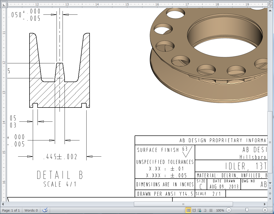

Here is an example of a C-size drawing imported into word using this technique:
This is the screen in Creo:

Your best bet is to find an intermediate tool, like GhostView, to convert something PTC can output into something Word can input. This will preserve the vector graphics detail in the drawing.
I've attached an example using a Postscript file converted to an EMF file and a PDF converted to an EMF.
The first was done with GhostView, and the second was done with Inkscape.
Inkscape did a better job preserving the line widths and line colors, well, shades of gray.
If you use this on drawings, you can ungroup the picture which will convert it to Word's internal format, and then delete or alter parts of the drawing as desired. I found it handy to color everything pale gray except what I was working on as a way to emphasize an area of interest.
Note - Word used to be limited to C-size images due to wrap-around from limited precision. If you try to import something bigger than that it will be - different. When creating the original PS or PDF make sure the output is to a C-size or smaller format page, even if the actual drawing is larger.
If you care to upload a sample drawing to avoid having to get Ghostscript or Inkscape installed, I'd be happy to convert one and work any bugs that might show up.
