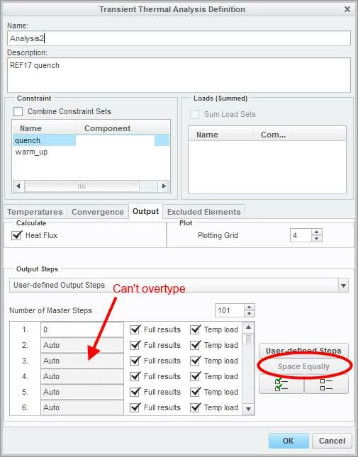

Hello there,
Creo2.0 M060
A transient thermal analysis, requesting full results at each user defined interval ...
1. I cannot space the master steps equally, the button is greyed out (attached screenshot)
2. I cannot overtype 'auto' with my own numbers.
3. Despite full results being selected for each time step (whatever that is determined by the s/w), only full results for time=0 is available to view.
4. In Structure I get the error message that there isn't a thermal analysis with user defined steps.
Soooo,
I presume we are being ushered toward steady state with nonlinear/Use Load Histories as with the nonlinear buttons pressed it appears I can do the above (haven't actually run a model yet)
The help guides users to create a transient thermal by 'FILE>NEW TRANSIENT THERMAL'
Have I missed the point or is 'transient thermal' about to disappear in the form that I used to use?
PS. Why can't I have negative convection coefficients any more?

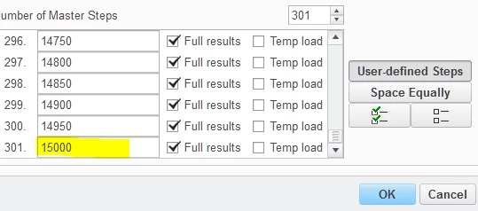

You need to scroll down to the last step and enter your preferred end-time in the last time field. then you canspace equally (now it does not know the end tine, that is at "auto"as well).
I highlighted the field
Erik

It might be that equally spaced is the default and is repersented by Auto. Would be nice if it showed the values.
Try clicking on user definded
to see if it will allow you to over ride the values.
Erik

I have always done it that way and so was the first thing tried.
What version are you using?
Creo2.0 M060 does not let me
Charles
December 5, 2013
Charles: I have Creo2.0 M010
Erik
