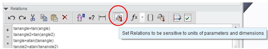

Both answers are "correct". In one case Creo evaluated the expression using radians, the other is in degrees.
In the case where you've specified your units, Creo has converted them to radians which is the default in the IPS system of units (I can only assume you are using IPS since that is Creo's default). I believe this is occuring because you have "mixed units" in your relation because the trig functions use radians and you've specified the unit of angles.
I did a quick test by taking the tan of angle specified as degrees and then converted it back to the angle using atan. As long as the units are consistent, I didn't see any problem. 15 degrees became .004569 but then became 15 degrees again when my parameter I read the relation back into had the units of degrees. It works correctly, you just have to be extremely careful with your system of units and how they are handled in relation functions.
You can tell Creo to ignore units in relations and it will behave as if you didn't specify parameter units to begin with. Then your "wrong" answer will never show up...just make sure you aren't relying on the ability of relations to convert units.
Click the button below or set the corresponding config.pro option:
relations_units_sensitive
December 17, 2013
Thanks Eric. That looks like a global toggle. That is scary!
December 17, 2013
I believe the config.pro is global but the button toggle is specific to the object you are viewing.
