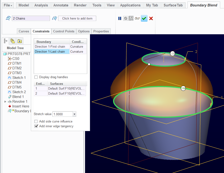

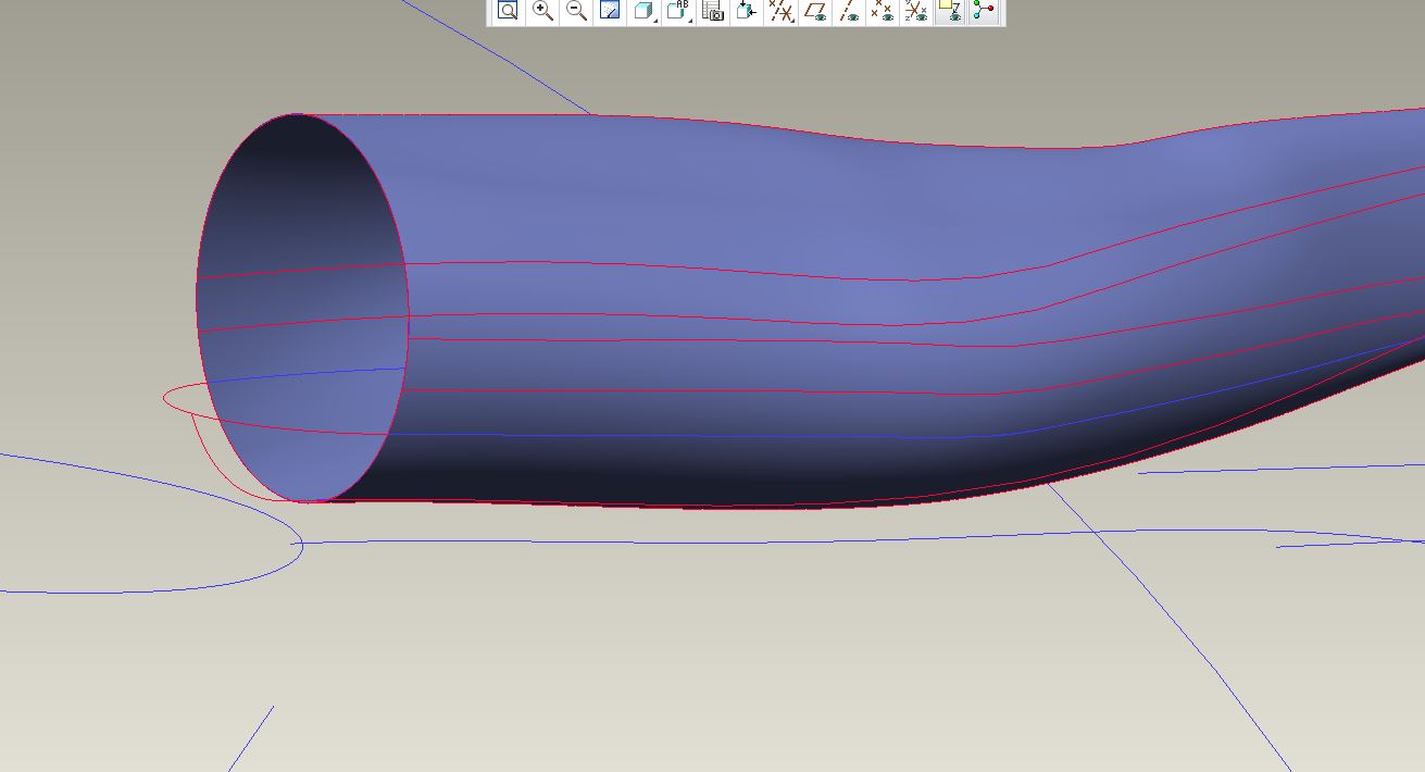

I have a troublesome rib that I'm developing.
The contour is variable through the length but towards the 2 ends the opening is a true diameter.
I can throw an axis on the edge of the opening and revolve a diameter, but unfortunately there is tangency angling into the end opening and the resulting diameter doesn't cross the true center of the open diameter, meaning the Revolve is not tangent with the Boundary Blend.
I've tried applying a Sweep through the red intersect curve shown in the attachment using the edge of the opening but could not get a result that worked.
I tried ISDX but it didn't allow tangency at the intersect with the edge.
I've also tried different combinations of Boundary Blend with no success.
In our other CAD software we would only need to use the Fill Gap command and as long as there was good tangency the problem was over with 2 clicks.
In my opinion this should be simple yet it's got me at wits end.
Any ideas in how to close this up with a tangent round surface?
Best answer by TomD.inPDX

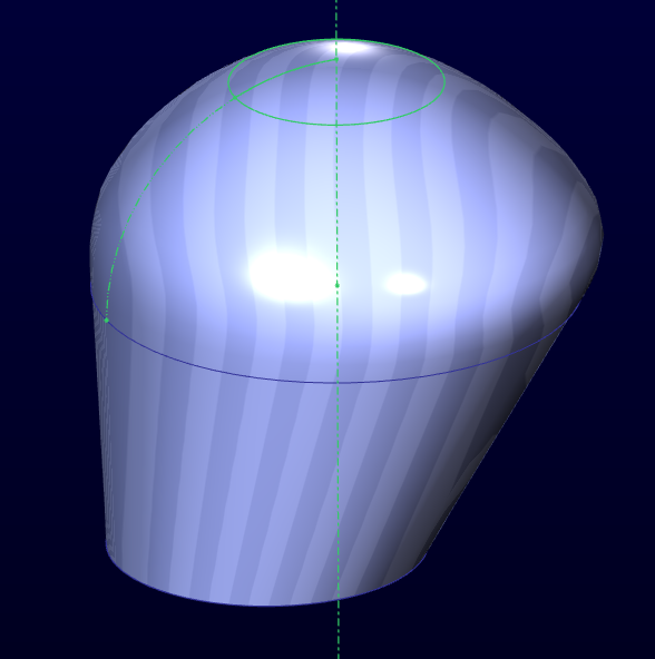

You can do a boundary blend between a "true dome" segment and the edge of the rib body.
Be sure to select the intent edge of both features.
pimm15-MoonstoneAuthor
June 3, 2014
This sounds like a very good idea Antonius.
As long as I can establish a true position for the dome feature I'm thinking this might get me past this difficult feature.
I will give this a try.
June 3, 2014
Hi Steven,
Yes, the opening is a true diameter. Everything along the boundary blend however is not true to any shape.
June 3, 2014
I think what Paul was conveying is that the surface leading up to the circular edge was not "normal" to that edge. Therefore, the revolve could not be defined Tangent as the transition varied. A case could be made for variable section sweep but it would require a linear transition that could be followed as the sweep progressed.
