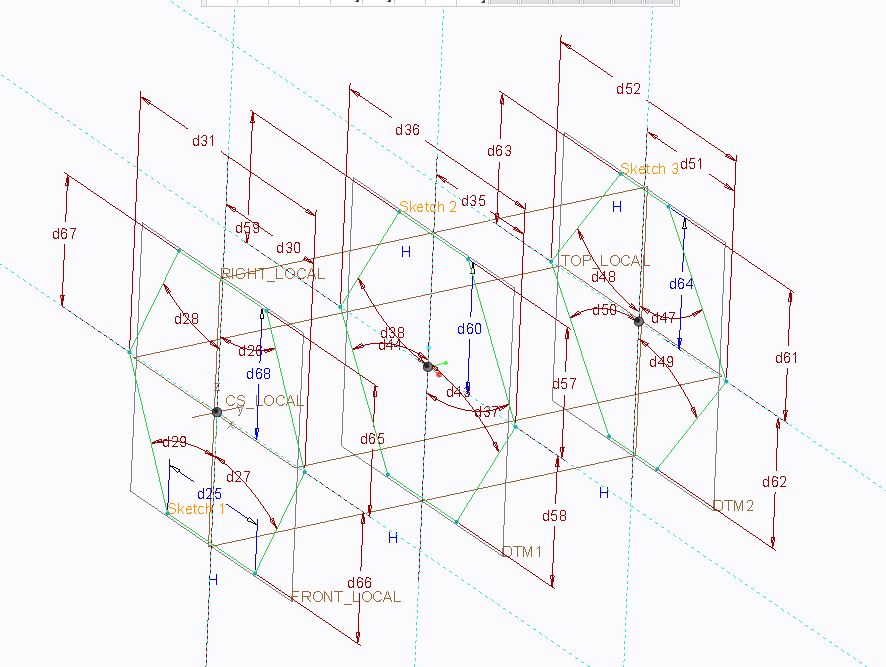

To give you a better grasp of what I am working on I'll attach a snapshot of a few of the sections.

I've made another simple series of sketches just in case it might help by setting up a simpler relation table. I can place this on the net if it would help.
I'm thinking that I would like to tie all the sidewall features to a single draft feature from the 1st sketch. If I add a degree of draft to this single feature I'd like it to update the remaining sidewall drafts in the sketches by the same offset value.
February 24, 2015
Hi Paul, maybe you are over complicating things here. Why so many sections? Maybe i am not fully understanding your finished geometry, so apologies if i am not. If i am understanding things right, i would have thought 2 sections, one at each end of the sweep would suffice, with a simple relation controlling the draft angle of sketch 2. If indeed you do need all 14 sections in your sweep, you certainly don't need 56 dimensions adding to the table, each sketch would only require 1 dimension. You need to create 'equal' constraints within the the sketch itself. Take your sketch 1, d26, d27, d28 & d29, i assume have the same value, in sketcher make then all equal, you only need change 1 dimension to manage the others.Then your relation might look something like d38=d26+1, d48=d26+2 & so on.

pimm15-MoonstoneAuthor
February 24, 2015
John,
I appreciate your reply to this confusing topic.
Unfortunately I think I over simplified the 2nd sketch set that I attached just to show a simple example. There might be an angle or 2 that happen to be the same draft but as a rule all the draft angles in the sketches are different values.
Based off your reply I should be able to control all the angles but it would require writing 55 different sets of equations based off of the original draft that 1 degree was added.
I will try this inside of my simple model with sketches.
I am wondering whether you could rename these 55 draft features to a common name that would add 1 degree of draft to each of these with only 1 equation line?

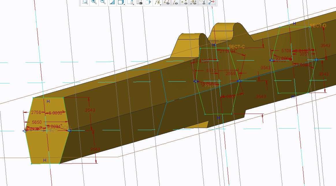

February 25, 2015
Frank:
I'll screen capture the other more complicated end.
This is the reason for the sections. I copied these sections directly from the customer model. This view shows the sections fairly well but there also is a good degree of twist in which you can't see.
This picture shows the twisting involved with the datums.
I have used VSS successfully in the past in applications like this. The reason that I like this is that I was able to capture every draft angle value in a family table and by incrementing by 1 I could get a true value for this change. I would like to see how you might offset the corner intersection to reflect a 1 degree change with VSS, but this gives me a value I can trust. Unfortunately for customer proprietary reasons I can't release this model online.
John: Perhaps these pictures help explain what I'm trying to achieve. I was thinking that it would be best to show the simple part of this model, but it doesn't adequately describe the complications.
To be honest I am happy with the results I am getting from Family Tables. Someone today showed how I could use Excel to quickly change the angle value (of course that is once the numerous angle values already were captured)
I'm still holding out hope that there would be a way to parametrically change just 1 value to update all values, but until that time I'm fairly happy.
