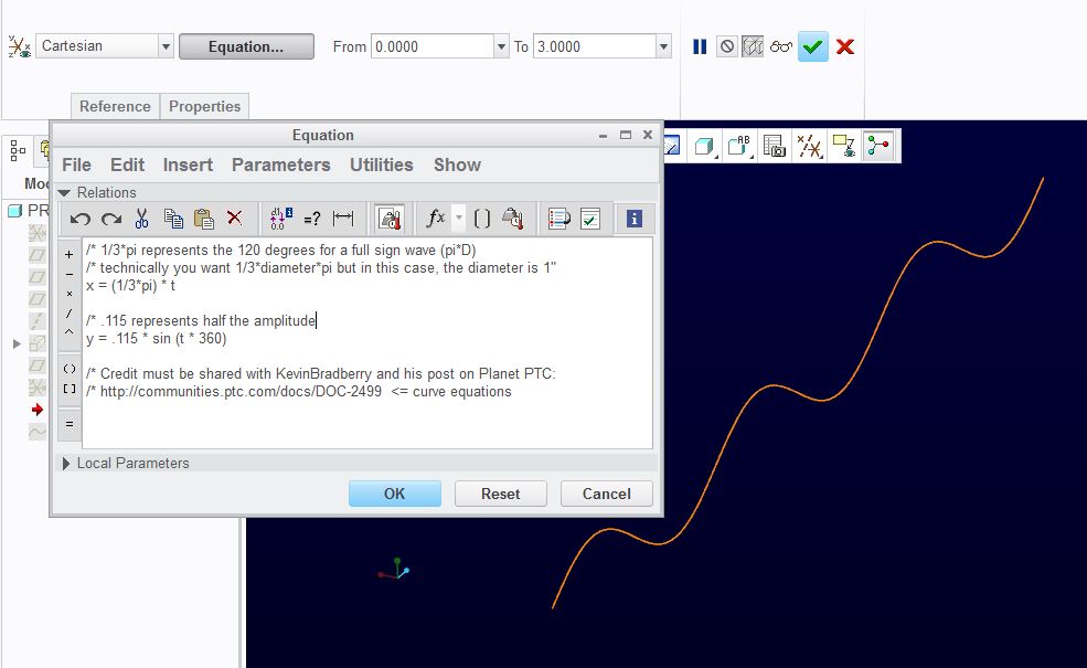

  • Extrude cylinder for Wrap of sine wave.
  • Datum curve from Equation
  • Sweep solid body and patterning quilt (surface) from Wrap
  • Revolve for radial patterned features
The sine wave was generated with the following curve equation.  Also be sure to link to the very helpful document by Kevin Bradberry here:

0:09) 1st you see the cylinder created so I have something to wrap the sine wave onto.  It is obviously a surface feature but a solid will work.
0:22) Creation of the sine-wave datum curve.  This uses the newly created CSYS CS1.

March 13, 2013
Persistence makes perfect.  The equation for a cylindrical sine wave:
/* cylindrical version
r=1
theta= t*360
z=.1*sin(t*(360*3))
/* cartesian version
x=1*cos(t*360 )
y=1*sin(t*360 )
z=.1*cos(t*(360*3))
PROBLEM!  The "normal" to this curve plays havoc with a Sweep feature.  Although the wrapped version is identical to the equation curve of the cylindrical sine wave, they act very differently when used in a Sweep feature.  The assumed "normal" is not the same.  This will become obvious when you define the section or interrogate the object that it creates.  Awareness of this limitation will help you find alternative work-arounds.
If you follow the method defined in the video, your wave washer will come out accurate; "flat" and consistent in thickness.
