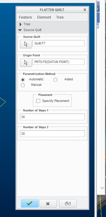

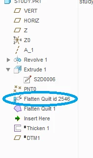

(Using Creo 3.) A colleague sent a "legacy" part with the below model tree. I am familiar with seeing the flatten quilt feature with the purple icon. When I go to edit the flatten quilt feature above it (circled in blue), a popup menu with options (more than the norm) opens (See below). The two features produce different flattened quilts. The flat produced by the feature circled in blue seems to be more accurate. The problem is I cannot find the feature circled in blue or how to adjust the flatten quilt feature to produce the popup menu. My colleague doesn’t know how the original designer made it. Any thoughts on how I can get these options?

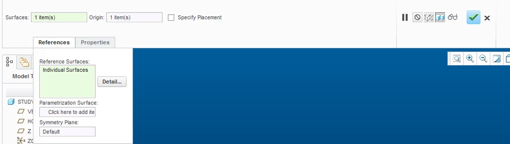

My guess is that this may be the old Flatten Quilt UI.  Since it's part of the legacy model, it hasn't been updated, and is still using the old UI, when attempting to redefine it.
I don't think there is a way to get back to that same UI.  Using the menu picks of Model > Surfaces > Flatten-Quilt Deformation, will bring up the new dashboard UI.
You can upload the model and provide the release you are working with, if you would like someone to take a look.

When using Creo 3, instead of a popup menu I get a ribbon menu with far less options.
