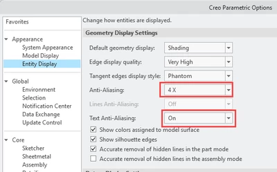

    Nov 6, 2025 5:22 PM UTC
    Try turning off anti-aliasing, and text anti-aliasing. File, Options, Appearance, Entity Display.
    If that works, you need to check your graphics card for compatibility and try updating the drivers if it is supported with Creo. This is common if you don't have a graphics card.
