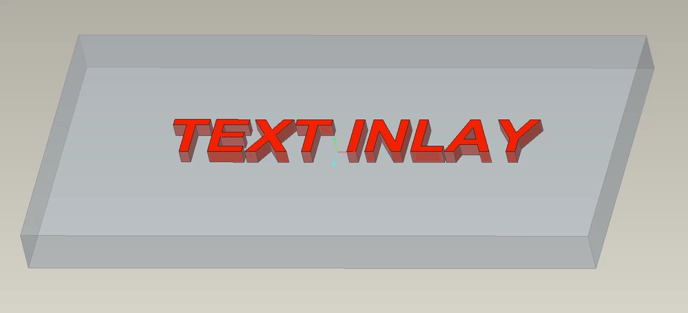

This is one method to create the geometry using multi-body functionality. It is very efficient, and no projection of the sketch required. See the enclosed assembly and parts. This is all driven from the master model "mb_master.prt". Creo 7 models enclosed. All changes to the text and the plate can be driven from the master model.

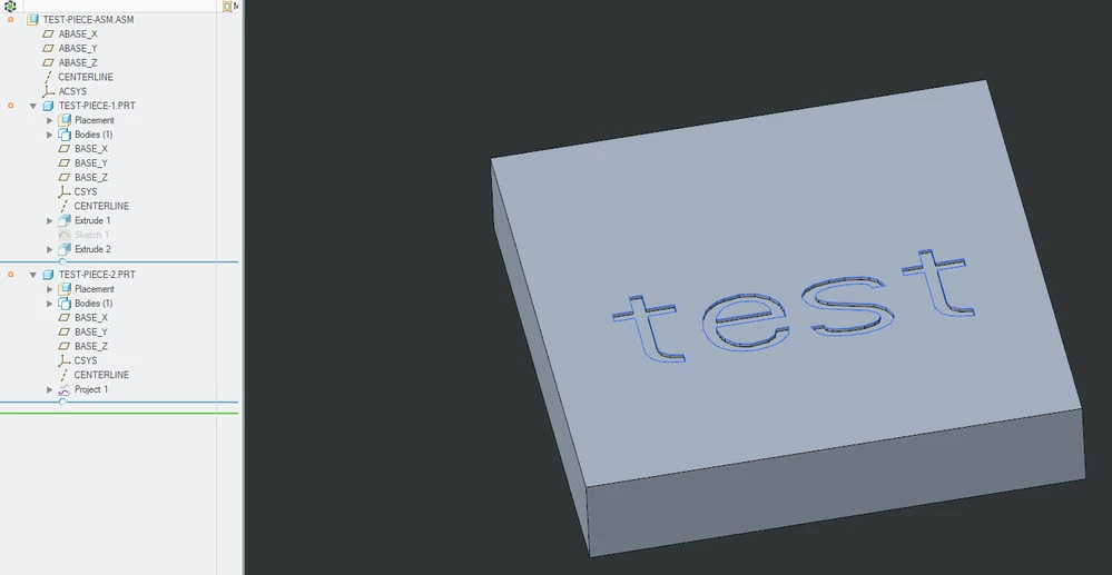

I am 3d printing a multi color object which requires a multi bodied part. What I do is create my 'base' part with cut extruded text, then create an assembly and then assemble my 'base' part. I will then create a 'text' part but don't create any features. I assemble the 'text' part in my assembly. Within my assembly I will activate my 'text' piece and project the text sketch from the 'base' part, then extrude in the text. This gives me two parts to export as an stl and then print with multi colors.
However, in Creo I can either use the loop project command within in my sketch command and select each character 1 at a time (super time consuming when you have lots of text) or I can create a projected sketch. But the projected sketch does not allow me to create an extrude.
I can't screenshot what I am actually working on but here is a simplified version of what I am trying to do:
I need to fill in the words 'test'. You can see I created a projected sketch under test-piece-2 (based off the sketch on test-piece-1). It just won't let me extrude it.

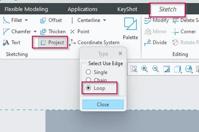

What you can do is to create a new sketch in the other part ans inside the sketch 'grab' the sketched lines of the original sketch via the sketcher function 'project' with the option 'loop' for ech letter.
This sketch can then be extruded and will follow any modification in the original sketch.
bterry274-ParticipantAuthor
Jun 4, 2024 5:59 PM UTC
What's the point of a projected sketch if it's not even a sketch?
I do know about the loop command under project. However, that allows you to loop 1 character at a time. If I have 100 characters to project that is going to take quite some time and be quite annoying. Especially when I already have a controlling sketch with all those characters in it.
Jun 5, 2024 12:48 PM UTC
This is very helpful, thank you.
