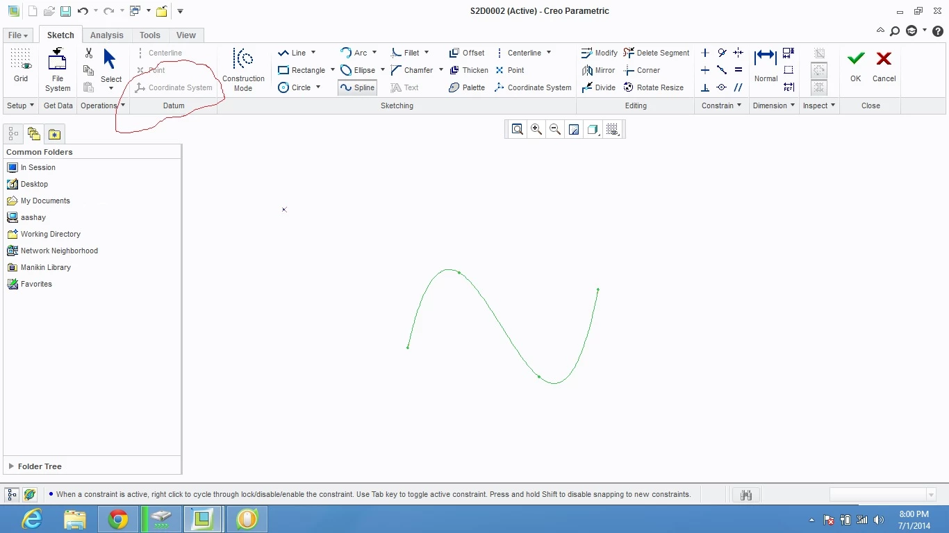

i am not able to insert a cordinate system into datum graph. Graph cant be used without the coordinate system. coordinate system option is not highliged.

That's because it's "geometry" coord sys and it's used to place datum that will be available outside the sketch. In graph feature you need to put coordinate system from Sketching group (just look to your right), which is a tool for placing construction datums, that are internal for the sketch.

Use Create Coordinate System button from Sketching group.

thank you very much sir
