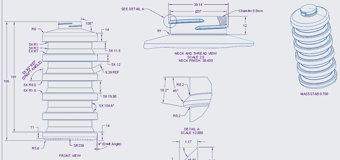

Unable to remove the sketch in the ISO view
I tried doing the suggestions in this topic: Hide sketches from drawings | Community
but in my drawing, Still I’m still not able to remove the sketch in this ISO view.
I did hide all the sketch layers and the sketch and saved the status.
I’m using creo 11.0.1
Please let me know if I missed any steps

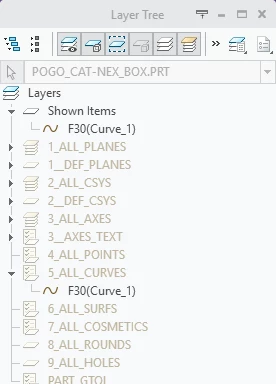

    It is difficult to diagnose without the model to interrogate since there are many options to look at.  It appears the sketch is in all of your views (Blue lines).  Here are a few things to look at.
    • In the model:
      • Is the sketch (and any copies) on a layer?
        • Open the layer tree
        • Expand the layer it should be on.
          • Is it there?
          • If not, edit properties of layer and select the sketch to add it.
        • Expand the Shown Items layer (if there)
          • Is it there?
          • If it is, RMB and select Remove Item.
    • In the drawing:
      • Is the layer hidden?
      • Are the view layers Drawing Dependent?
        • In layer tree activate the view, select Layer Operations, select Drawing Dependent

    Aug 6, 2026 12:18 PM UTC
    Thanks, it worked.
