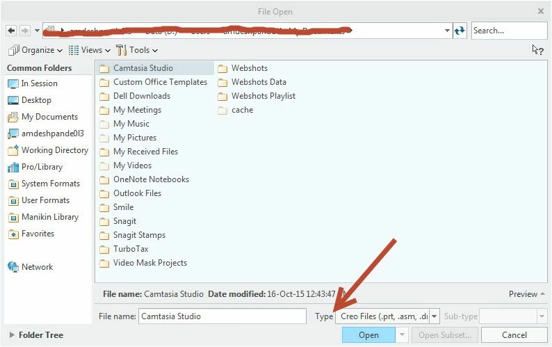

I have saved a .obj and .stl file in a folder, but in Parametric, when I go to Open (or Model > Get Data > Import), I cannot see these files.
Is there any obvious reason why this may be the case?  I have tried selecting both different types in the File Type drop-down, but still cannot see.

What is the Type filter set to?  Did you try All Files (*)?

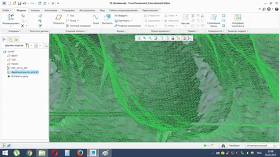

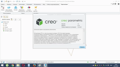

Good afternoon Rusty007!
Everything is working. What version of the program are you using?
Which module you are used - Creo Direct or Creo Parametric ?
Sicerely, Evgrafov Aleksandr.

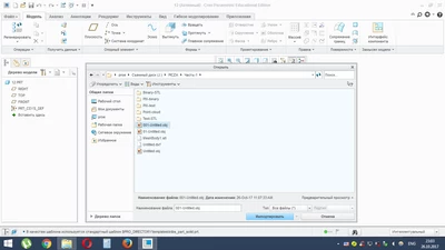

Hi... ok, have solved. I had a dot in the filename to represent version number (I.e. v11.03) and looks like Parametric was reading file type from there. Have stripped out the dots and can load fine now.
