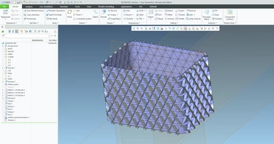

I'm designing a Isogrid geometry in Creo 10, but I'm having trouble with the Thicken feature. Creo allows me to thicken only one surface of this "box"—it doesn't matter which surface I choose, it always works for the first one. However, when I try to thicken a second surface, it fails.
Does anyone know a fix for this?

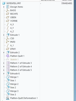

Since most people here are professionals using commercial licenses you will need to provide more information.
  • Include model tree
  • Video
  • Explanation of how created
  • More pictures
  • Etc.

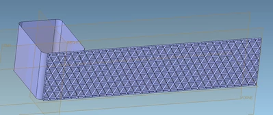

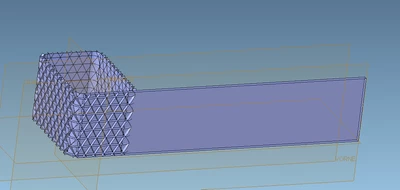

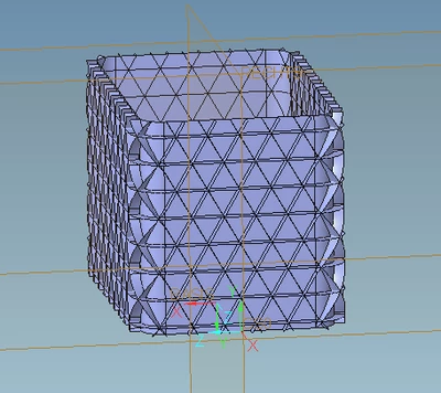

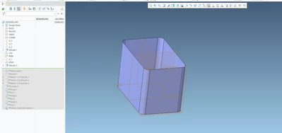

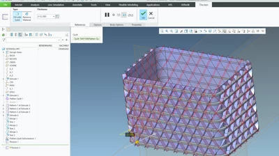

MG_9712099_3-1740577581022.pngMG_9712099_4-1740577626055.pngMG_9712099_5-1740577648924.png
I basically combined the unwraping in this video https://community.ptc.com/t5/3D-Part-Assembly-Design/Draft-a-wrapped-sketch-around-cylinder/td-p/795659 and the method for the isogrid in the part below.

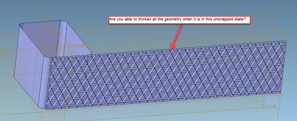

Feb 26, 2025 2:15 PM UTC
Are you able to thicken all of the quilts in the "flat" state? If not, then it is not likely going to work in the "box" state. I am not sure what algorithm flatten quilt uses but in my experience that is not a feature I would use for engineering purposes. It is not the same as unbend or flatten in sheet metal mode.

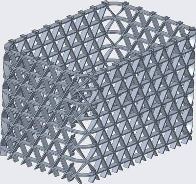

Why you don't use a 2.5D lattice feature?
See an example I modeled with the lattice feature.
Michael
Feb 26, 2025 2:59 PM UTC
my suggestion is to flatten the quilt, then thicken it, then apply a lattice with a shell option, and then flatten and quilt back.
Michael Bourque
