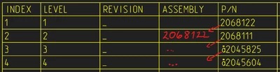

To create a report for Fire Certificate Inventory List (EN 45545) I want to use a repeat region of my top-level assembly.
For every part, I need to report the assembly where it is mounted.
Is there any option to report the Part Number (or any other parameter) of the immediate upper level?
I hope the picture below can explain this case better.
Thanks!

I did it with a Repeat Relation.
As far I see PTC will do a Depth-first search. And this is only one solution I guess..
You must have rpt.level and asm.mbr.name in your repeat region, else you don't have access to the corresponding vars.
The relation will be evaluated not recursively in Creo with a new stack, so the var values will be keept during this while/for Loop.
In Level 1 your Parent is empty "" and you save the name in lev1.
In Level 2 your Parent is lev1 and you save in lev2 the name
In Level 3 your Parent is lev2 and you save in lev3 the name
... and so on
You must have this for the amount of levels you expect.
PARENT is a Repeat Relation Var -> rpt.rel.parent, and must be added.
Here this example stops at Level 4, Level > 4 will set a static text, to force a relation edit.
I kept the relation easy to maintain, no "else"
if rpt_level == 1
 parent=""
 lev1=asm_mbr_name
endif
if rpt_level == 2
 parent= lev1
 lev2=asm_mbr_name
endif
if rpt_level == 3
 parent= lev2
 lev3 =asm_mbr_name
endif
if rpt_level == 4
 parent= lev3
 lev4 =asm_mbr_name
endif
if rpt_level > 4
 parent= "Please Extend Relation"
endif

To do this kind of thing with normal parts, I use a parameter in each part/assembly that is something like "partnoASM". In each assembly, I use relations to set this parameter for any components needing it, using the parameter that specifies the "partnumber" for the assembly.
Once I've done that, I can use the parameter in tables/notes.
A couple of difficulties you will have to consider:
(1) A part/assembly can be used in more than one upper level assembly. What do you do then?
(2) If a part/assembly doesn't have the "partnoASM" set, what do you want to have shown?
By and large, parts/assemblies do not have any sort of information stored in them that indicates what assemblies they are being used in. There is no way to query a part and show the "next level". Thus, I believe the only way to (possibly) implement what you want is via some sort of custom method like the one I loosely suggest.

Possible solution: Export table into csv file, import it into Excel and add requested information manually.

Reading your and Ken's answer, I understood that I'll have to export the list without this column and create a macro inside Excel to organize these numbers.
Thanks!
Mar 10, 2023 10:02 AM UTC
Hey.
It was easier than I thought.
I used this formula on column D (ASSEMBLY)
=LOOKUP(2;1/($B$2:B4=(B4-1));$E$2:E4)
Note that I use ";" as separator. Correct to "," if needed.
