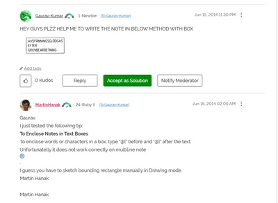

I should know is it possible to frame a note with a single frame on 2D model when you want to write on many lines like this screenshot. Because actually I just do frame each line only but not all the lines together.
Thanks for your help if you can give me tips.

I think you are attempting to enclose multiple lines of a note inside a box?
(from another post)
It sure seems that this isn't possible.  Please suggest a product enhancement idea.
