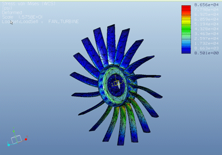

Let’s look at an example including a rotating turbine impeller.  To simplify the design, we are going to analyze it as a single part.
                  Turbine Impeller Design
Centrifugal Load (Angular Velocity and Constraints)
In this model, we fix the inside of the holes in all 6 Degrees of Freedom and apply a Centrifugal Load at the center about the axis of the model.  This Centrifugal load can be either an angular velocity or an angular acceleration.  When we perform a Static Analysis (even though it is considered rotating), we get the following results:
Static Analysis results showing Max VM Stress of full model (Runtime = 7mins)
Note that this same model can be run in considerably less time using Cyclic Symmetry constraints and only a small “pie” section of the model.  Since this model has 18 equally spaced blades, we can cut a 20 degree section out of the model and analyze that.  The only thing we need to add to the model will be a cyclic symmetry constraint.
                 Cyclic Symmetry Constraint
   Same analysis as above  (Runtime = 27 seconds)
Note that the results are within 3% of those from the full model which is usually within the convergence criteria of Mechanica and the runtime is 27 seconds as opposed to 7 minutes.  This might not sound like a great deal of time difference but if an optimization needs to take place as many as 12 iterations are run, the time difference now becomes 6 minutes for the cyclic symmetry model as compared to 84 minutes for the full model.

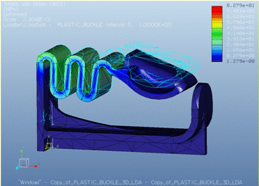

Other examples where runtimes can be significantly reduced are with 2D Plane Stress and 2D Plain Strain models.  Below is an example of a 3D solid model analyzed using symmetry constraints to reduce model size and runtime.  The Large Deflection Analysis (LDA) took about 11 minutes to run mainly due to the 5 load intervals.
3D Solid Model Analysis using Large Deflection (Runtime = 11 minutes)

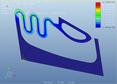

By running this same model as a 2D Plane Strain analysis, we have reduced the runtime to 18 seconds
2D Plane Strain Analysis using Large Deflection (Runtime = 18 seconds)
One thing to note is that the geometry should be considered to be infinitely thick for an accurate 2D Plane Strain analysis.  The difference in the results does lead us to believe that our assumption of infinite thickness is actually not valid for this particular geometry.  Here we can use this 2D example for design iteration behavior but not final results.
