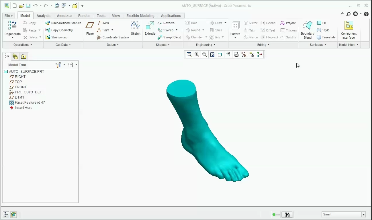

Using Auto Surface in Restyle tool of Reverse Engineering in Creo Parametric 2.0
  • November 11, 2012
  • 6936 views
Autosurface is a very powerful capability of the Restyle feature wherein you can create a patchwork of curves and/or surfaces automatically on an entire facet model or a part of it.
The three steps of creating an auto surface are
1)determining the scope
2)creating the patch structure
3)creating the surfaces from the patch structure
