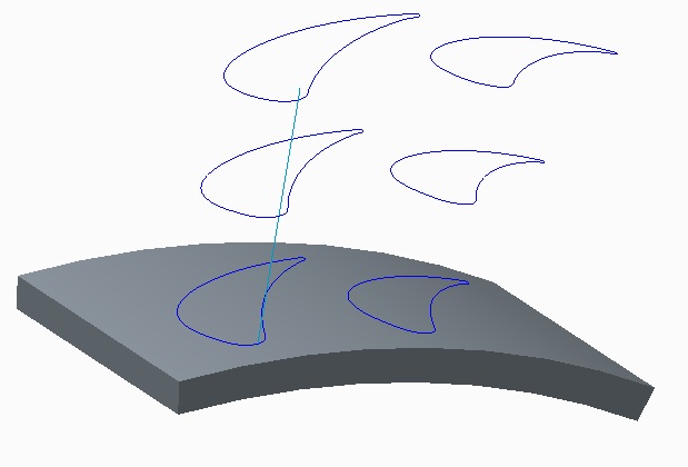

I am having trouble generating a swept blend through 3 sets of coordinates for a stator: hub, mid and tip. I have created a sketch for each set of coordinates and projected these onto the surface of the hub, radius 330 mm. I then offset the mid and tip sketches by the according lengths.
Creo will not let me generate a swept blend through these 3 profiles. I think the problem may lie with the fact they are curved but I am unsure as to why it will not generate. Any help would be greatly appreciated.
I have attached my part model. Project 1 and 2 are the hub profiles, copy 1 and 2 are the mid and copy 3 and 4 are the tip profiles.
