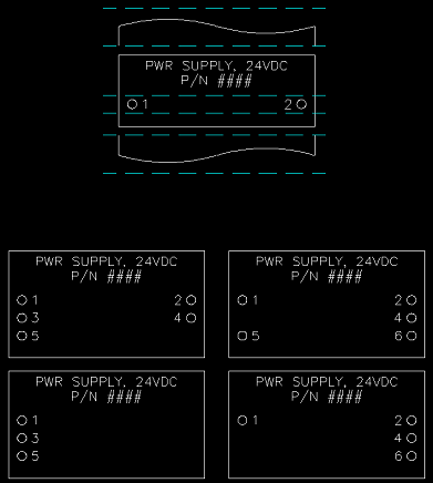

Is it possible to create a variable group that could produce some of the examples I have shown below?
    Best answer by JimBarrettSmith
    With variable groups the content in each cell would have to be consitent, meaning either 1 port or two ports thus it is not possible to vary the number of ports in each cell
    If you can reconfigure the layout of the shape so that you can control the configuration by cell then you would be all set
    make sense?
    thanks
    Jim

    I think that would be good for a family table.
    The family table would turn itemns on and off as required.
    The text and P/N would be defined in your family table also.
