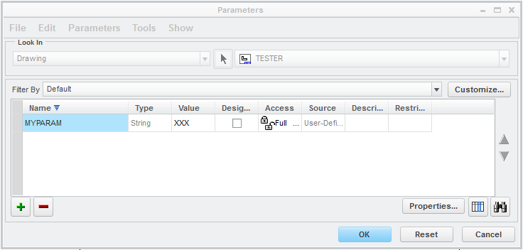

Hi Tom...
I just did the same test and had no problems whatsoever.

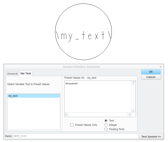

  1. Created a new drawing with NO MODEL, no template, no format. This is a completely empty drawing with no parameters
  2. Created one single drawing parameter called myparam set as a string with the characters "XXX" as the value.
  3. Created a brand new symbol, added a circle (just so it had some shape to it) and a note. For the note, I entered "\my_text\".
  4. Under attributes for the symbol, I specified a free point as the location.
  5. Under the Var Text tab, I replaced the preset value of my_text with the string "&myparam".
  6. Saved and exited the symbol creator.
  7. Placed the new symbol on my drawing... and it shows up as a circle with "XXX" in the middle of it.
Here's the symbol in the symbol editor...
Here's the symbol on the sheet...
Here's the entire set of Drawing Parameters...
This is Creo 2.0 M080 which, I think we all can agree, is a terrible build code to use... but this is what I used for this demo.

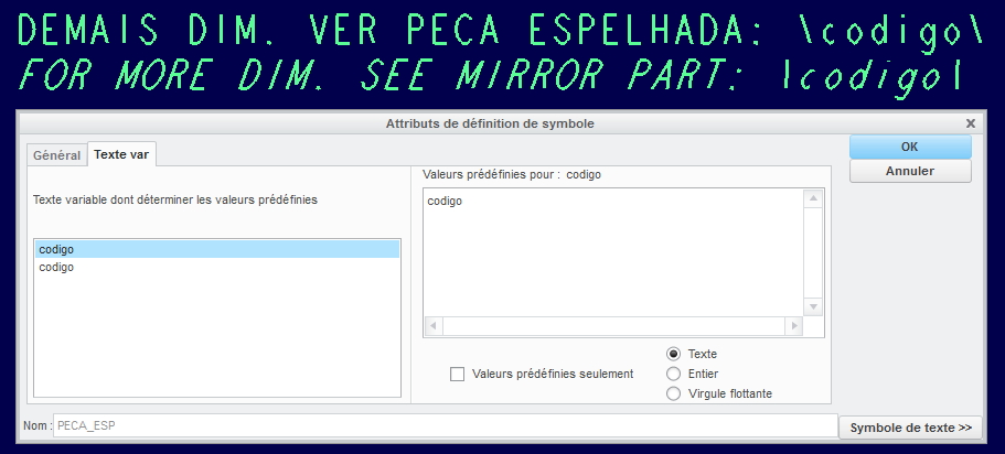

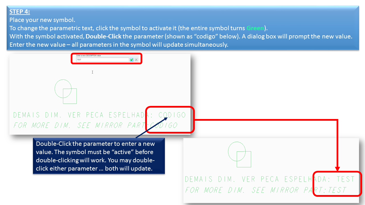

I give you an example of symbol below.
The first line is in Portuguese and the second in English but "codigo" has to be the same value (1 attribute)attribute.jpg
In symbol definition I wrote :
But in that case I have to enter a value for each attribute and potentially I will have a different value.
Thanks for your answers.

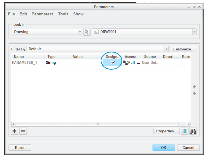

I dunno whether this is the answer but lets try
you can use parameters right? parameters in dwg
only thing is to you have to designate it and you are good to go... you can use it wherever you want... just one time edit you ll get the value changed wherever you want
thats all... you ll have to use this parameter in the note wherever you want like this
&PARAMETER_1
Applying it to your case
DEMAIS DIM. VER PECA ESPELHADA: &PARAMETER_1
FOR MORE DIM. SEE MIRROR PA RT: &PARAMETER_1
Hope this solves..

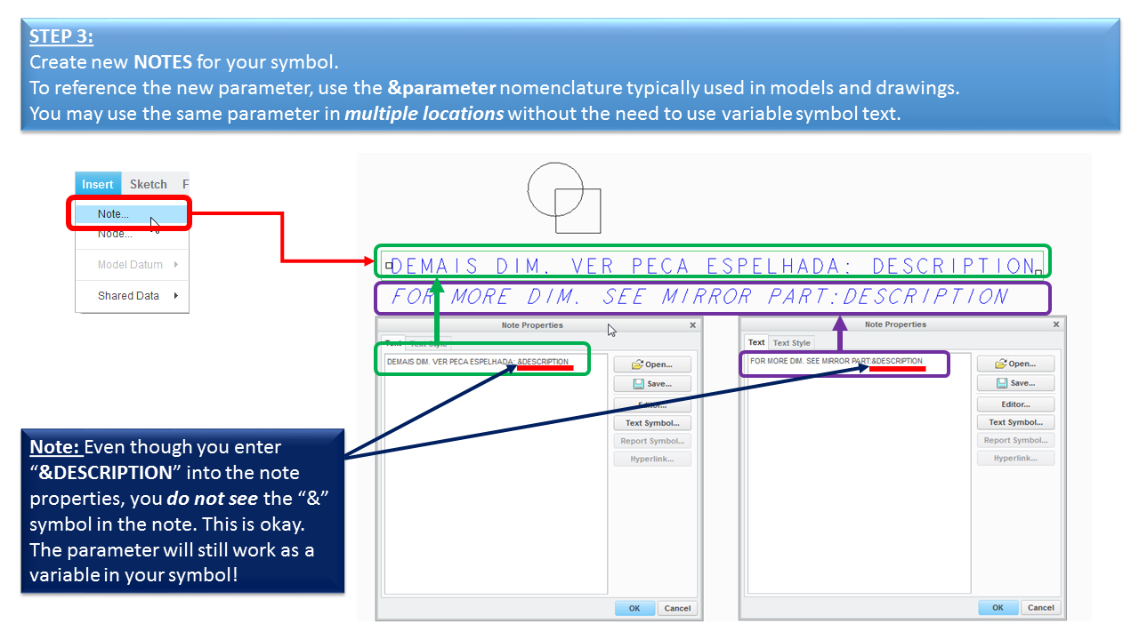

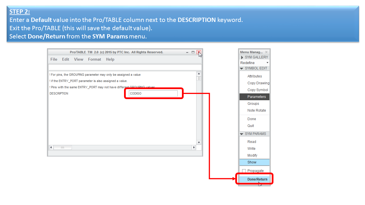

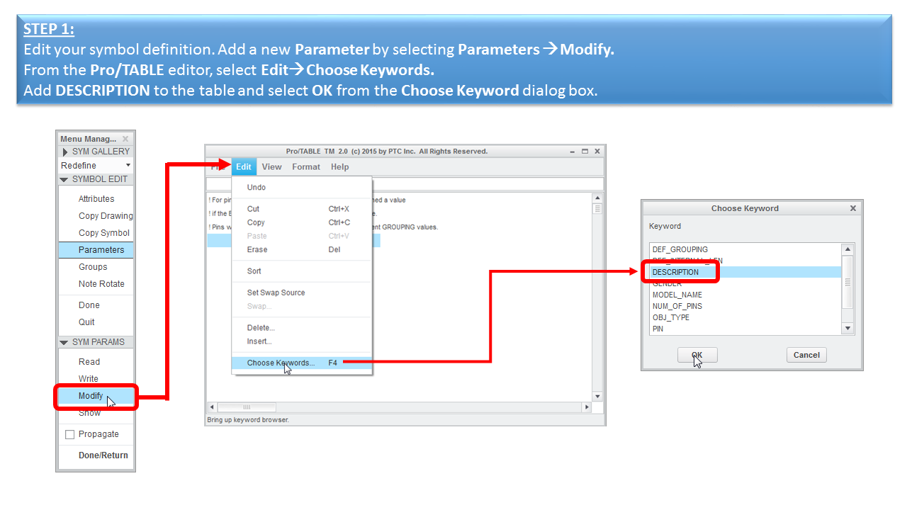

Here's what you need to do - utilize rarely used features intended for cabling inside of SYMBOLS to solve your problem. Various people have suggested parameters (drawing parameters, model parameters, etc). Someone else mentioned it might be possible to use multiple pieces of variable text but that this will require changing each piece of text individually. There's actually a better way!
Inside Symbols you can set Parameters. These were intended to support cabling/component parameters but you can "steal" them for your own purposes if you wish. Everyone knows how to use variable text in symbols with the backslash technique like this: \Variable_Text\ but there's an alternative! You can simply use a parameter stored in the symbol. For this example, we're going to steal the DESCRIPTION parameter from the cabling parameter table and repurpose it. You can actually invent your own parameter, too. It's not really necessary to use the cabling parameters but we'll stick with repurposing one of them for this example:
Edit your symbol definition and follow these steps - click the images for a larger, more readable slide:
If you don't like the standard &DESCRIPTION parameter, you can skip choosing a parameter from the Edit-->Choose Keywords menu in step 1. You can open the Pro/TABLE and type any parameter you wish into the table. Provide the parameter name in the left column and a default value in the right column. Be sure to use your new parameter with the &<new parameter> format in your note and everything will work perfectly. As an example, here's an example of adding a parameter called "NEW_PARAMETER" to the parameters table:
The lesson learned here? Do not believe everything PTC Tech Support tells you. If they've told you "it can't be done", come to PTC Community before you throw in the towel.

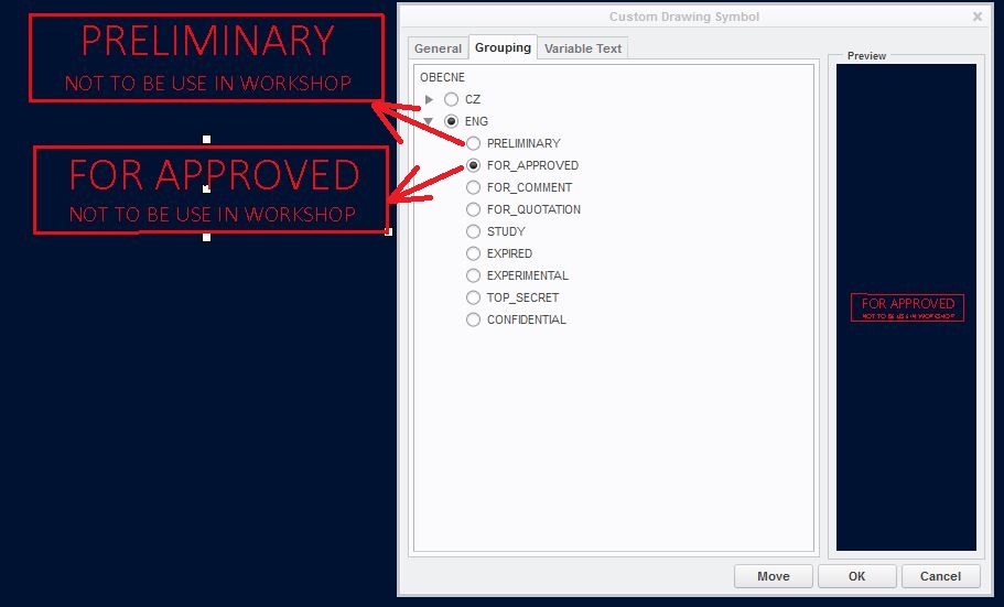

Sep 4, 2015 10:02 AM UTC
Just oher idea:
What about symbol grouping?
Source file is attached.
Hope it can helps someone.
