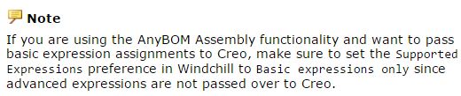

3. This is where we are stuck.  Originally we were considering using External Simplified Representations generated from the Simplified Representations to drive the Windchill EBOM.  We now question if building the Master Assembly as a Configured Product is the correct approach?  We were originally advised we needed to wait for the Options Modeler which will not be available until a future implementation.  I have attempted to locate what the difference is between the Options Modeler and Variant Builder.  Is there a difference?  I search for Options Modeler in Windchill and get little to nothing.  Here is some of the internal Windchill help:
Upon further research I come across the term "AnyBOM Assembly" located under the topic "Managing Configurable CAD Structures".  Instead of using the term "Overbuilt" this documentation appears to use "Overloaded Structure"?  I can only assume they are one and the same?
4. We use a strict naming and numbering system.  Each of our assemblies and sub-assemblies will have a Number/Name assigned to them.  We can only assume these numbers will appear in the Model Tree and there is an option to further describe the part?  What is in question is what does Windchill recognize?  Without experimentation we will not know until someone tests.
