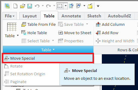

I tried to set up drawing note's vertical justification as middle. That option is grayed out. I tried to search into drawing option as well as configurator properties, but no success.
Could anyone please suggest how to set up vertical alignment for note?
Thanks and Regards
Ketan
May 11, 2016
Hi again,
If you wanna position the note vertically use Move Special.
May 11, 2016
I think that vertical alignment can be set inside table cell, only.
MH
May 11, 2016
Confirming that vertical alignment is within table cells.  Note that you can use @O:
Some text above the leader
@OLeader line goes here
This is below
to declare where the leader elbow goes, which is useful for solving some things that would prompt you to ask this question.
