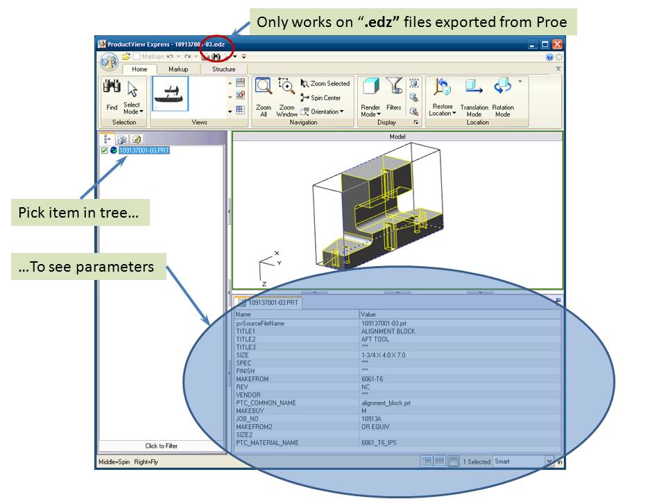

I can only get it to work on an .edz file exported from Proe and it only sees the global part/assy parameters. To my knowledge parameters will not come thru if you are viewing the native Proe files. This has been on my wish list for quite some time now as this capability would help our inspectors on the floor tremendously. Hopefully when the whole Creo package comes together Creo/View Express will work better.

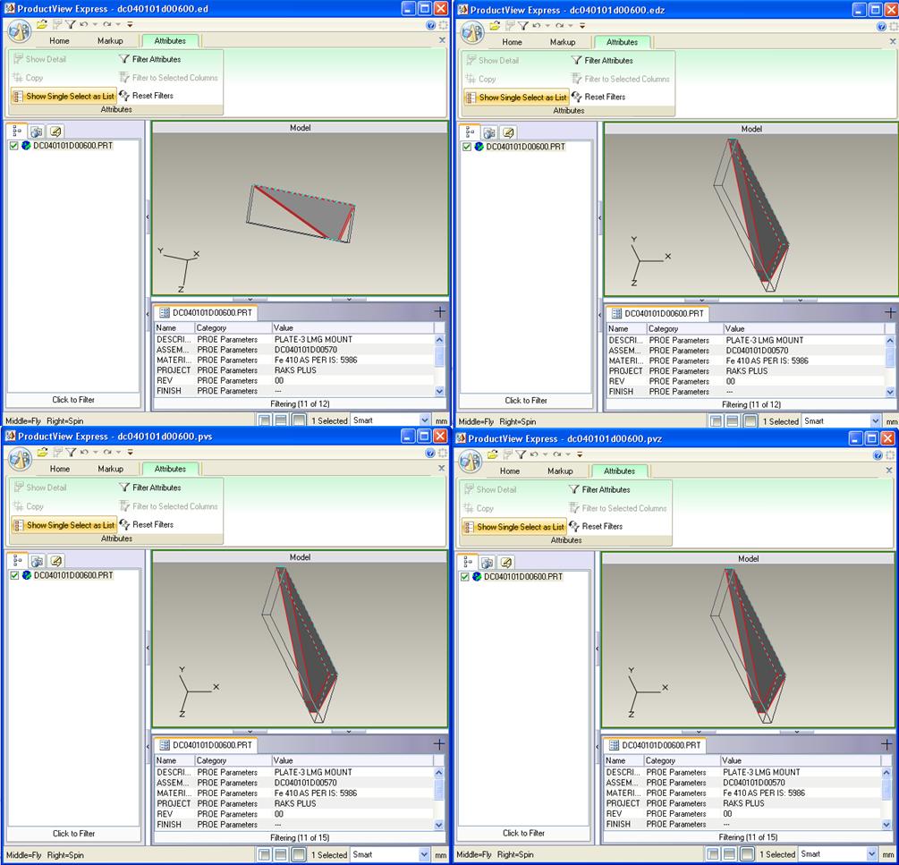

February 1, 2012
Hi
Product view express shows properties for all the productview extensions
The same should be for Creo View express I Believe
Regards
K.Mahanta
February 1, 2012
Hi
Creo view does not contain parameters at feature level or part feature details.
(Sorry but I believe adding more and more feature to the product view files will make it heavier in size.)
Regards
K.Mahanta
