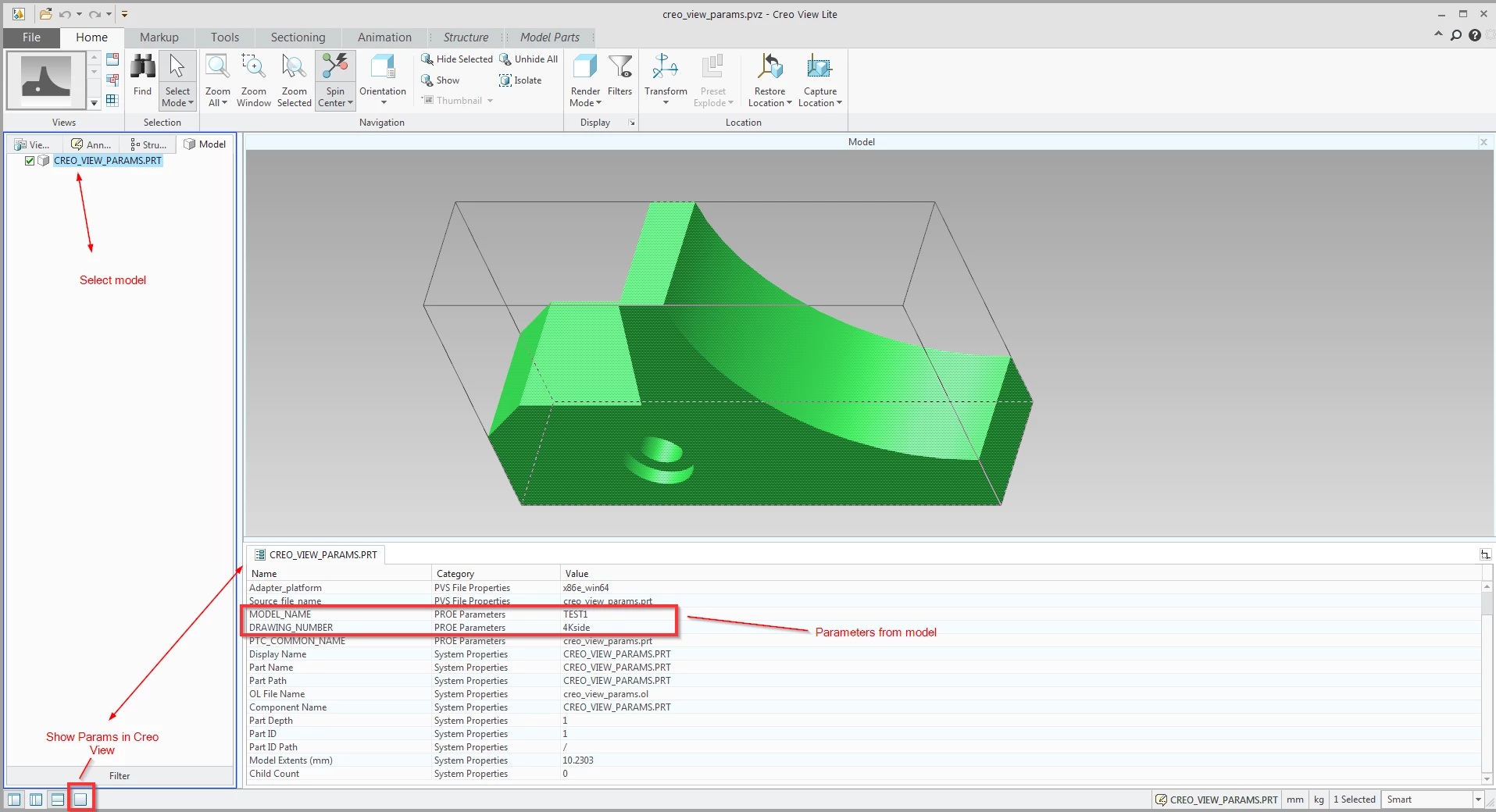

July 16, 2018
In Creo View is possible to see Creo model (asm) parmeters if you select corect visualization Tab:
