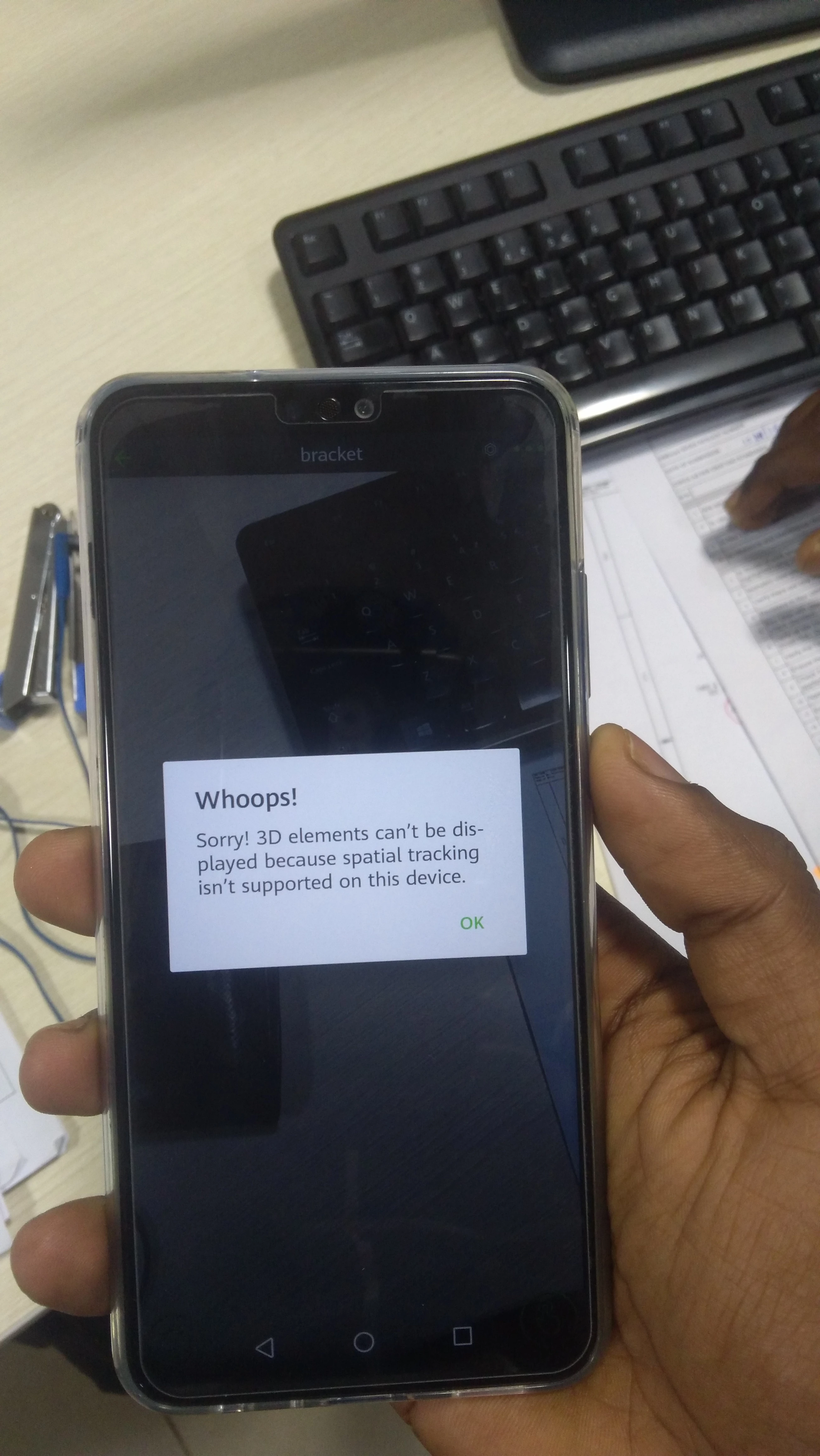

I created a 3D model, applied Spatial target and published, but unable to open in Vuforia View. I have attached the message that popped up. Need advice. Thanks.

The Spatial Tracking is built on Vuforia Engine's Ground Plane technology. It looks like the device you're using does not support Ground Plane (or else the operating system of your phone doesn't support it). Please see the list of supported devices and operating systems here: https://library.vuforia.com/articles/Solution/vuforia-fusion-supported-devices.html
Luke
December 19, 2018
I should add, this is for Spatial Tracking specifically. In Creo 4.0 M070, we reintroduced ThingMarks, which should work fine on your device.
