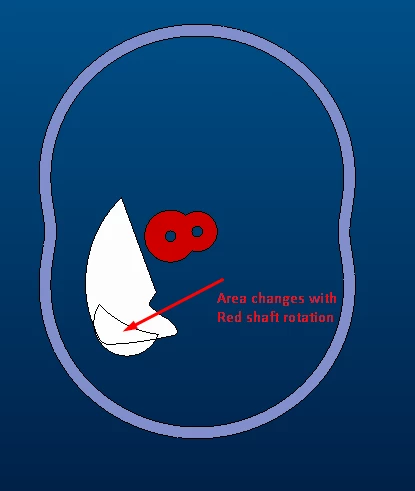

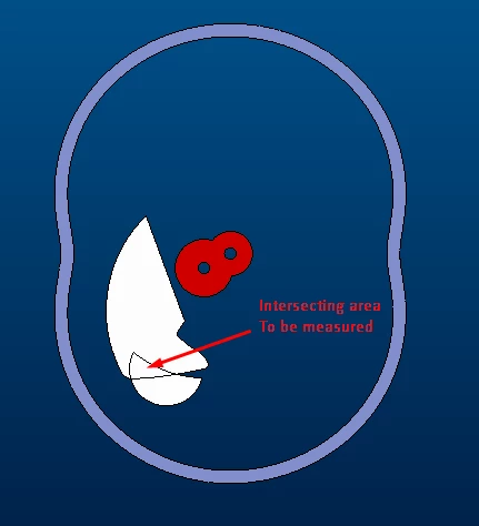

Im modeling a wankel engine with axial intake ports, i have the geometry and the kinematics and now i need to analyse the port opening vs. crank angle rotation.
Question is, are there any functions that could measure the combined area (or volume) of two parts in respect to the time or angle rotation ( i can set up both in mechanism ) and export it to text file?
Thank you, if this question is not clear please ask and I will try to explain.

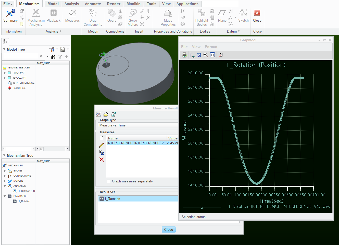

Best answer by psobejko
Ok, I looked a little bit more into it, and if you have the basic mechanism design extension, then you can plot and export various measures as your mechanism goes through its motions.  Here's a Creo 2.0 example of a small disk rotating within a larger disk about their common hole.  The analysis measure of the "interference volume" is being tracked as the servomotor goes through its motion:

February 2, 2017
Thank you, the way I do it is just moving the assembly by certain amount of degrees of angle while during each step I let the creo calculate the volume interference of the ports. As I have created the extrude of the area with 1 mm height the volume is calculated and I can ready it as a area. But I would like this to be automatised because its tedious work to do.
Any ideas?
February 2, 2017
Understood.
There are conditions in assemblies that remain dynamic.  I've had dynamic results read with an annotation within the assembly.
This tells me that you should be able to create a sketch that will regenerate with each step and provide the new values.
I am not coming up with anything where that sketch would not require regeneration but it is certainly worth a try.
If it doesn't work between parts, you might be able to get an area measurement to become dynamic.
Do the subtractions calculation in relations from area measurements.
if I wasn't buried in work right now I'd play with this, but all I can do for the moment is rattle your gray cells.
