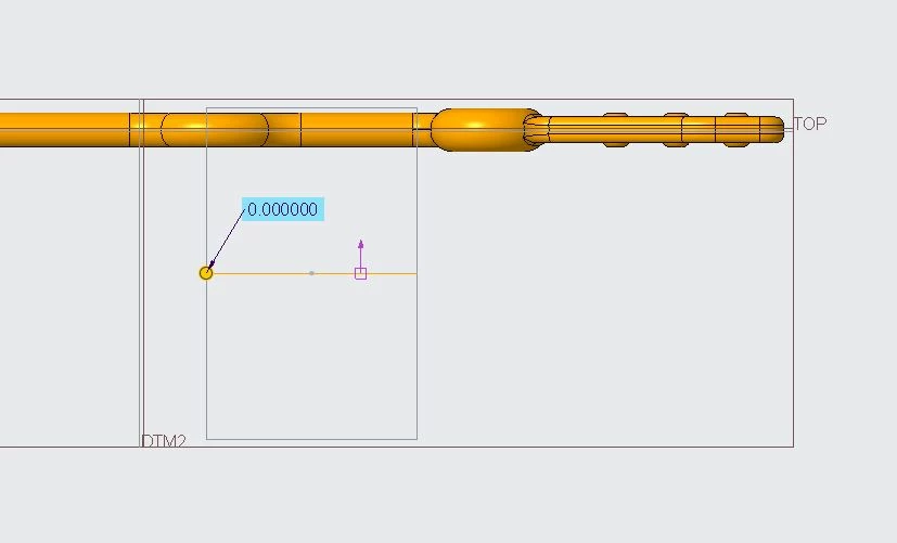

i've got a rubber strap that is modeled in its moulded state but for the assemble it need both end bent down.
part is modeled with the csys at the center of the part.
the first end is easy to setup. bend axis sits on the top plan as this is the middle of the part, moved the pivot to one end so that the unbent part stays in its original position.
the second end is not so easy as i cant get the bend axis to sit on the top plane, if you click center axis is puts it half way through the now bent part. and moving the axis when you are looking normal on the end of it doesn't work. moving the axis when the model is at a strange angle is difficult to get it where you want. also what do the marquee refs do?
effectively, in the enclosed image how do i drag the marquee box up and down. i need the yellow bend axis to be on the top plane of the part.

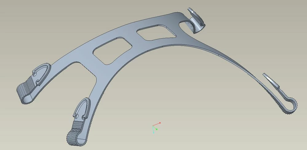

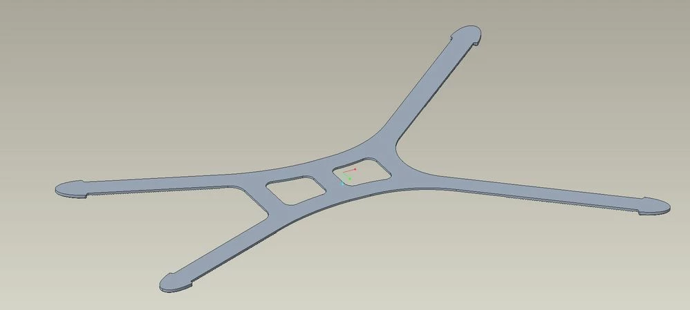

Warp is probably not the best tool for this. Check out spinal bend function to get your "bent" geometry of the part. I have used the spinal bend to do exactly what you are describing if I understand it correctly. With spinal bend you can parametrically control how the geometry gets "formed". Use of the perimeter dimension will make it it easy to control the bend zone and keep it where you want it. The example below was realized using spinal bend.
As moldedAs moldedAs assembledAs assembled
