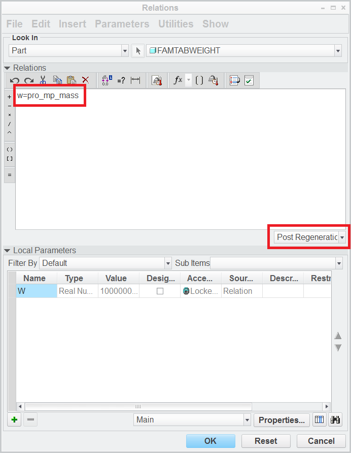

Try &pro_mp_mass:SESSION_ID. To get the SESSION_ID go to the top level assembly, open the relation dialog, and Show>Session ID>Assembly>Top Level, Creo should display it in the message area. I'd have to look at the units question.
June 9, 2016
you can investigate my example data created in CR2 M070.
It is important to define relations properly.
MH
