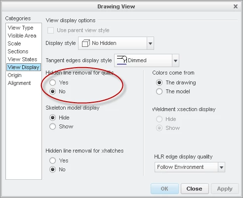

You can set the welds to a layer and turn them off there.
For the welds showing through the view, since they are quilts (surfaces) they don't follow the standard rules, you have to toggle the switch for HLR for quilts in those views.

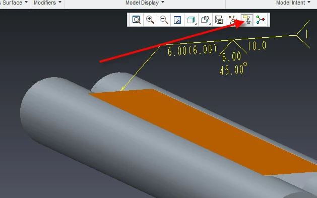

February 12, 2014
Just use the button to turn off the display of annotations.(See attachment)

February 12, 2014
Thanks Steve. This is what I needed. The welds on the back of the part are hidden in the view and the annotations are still visible.
I completely forgot about this setting. Hardly ever use welds.
