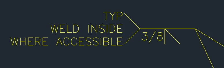

I am trying add multiple lines in the reference section of a weld symbol. Is that possible? If possible, how can i do that?
Want something like the attached image.

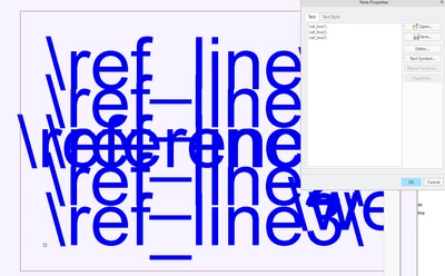

The weld symbol need to be defined for multiple lines of reference.  Our symbol is set up for 0, 1, 2, or3 lines of reference.  Depending upon the reference selected the correct note will be active in the symbol.
Dale_Rosema
September 7, 2021
Here is a link to an older post about making a custom symbol for more lines of reference text.
https://community.ptc.com/t5/3D-Part-Assembly-Design/Weld-Note/m-p/299415
