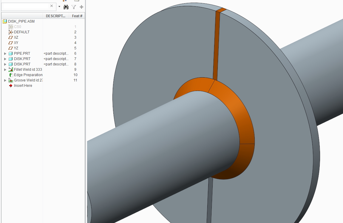

Attached picture shows my problem. I am welding two semi-circular plates to a tube.
I first weld the two plates together then weld the plates to the tube but the weld is split across the plate weld. I've tried everyhting I can to correct this without success.

The gap exists because there is a gap between the two surfaces as you would expect for a groove weld. For the secondary weld, it follows the surfaces of the original geometry with the gap in it.
I can think of two ways to fix it:
1. Don't create the edge/weld prep as feature in the model, do it as a weld prep feature in the welding application. Move/create your fillet weld prior to the edge prep in the model tree.

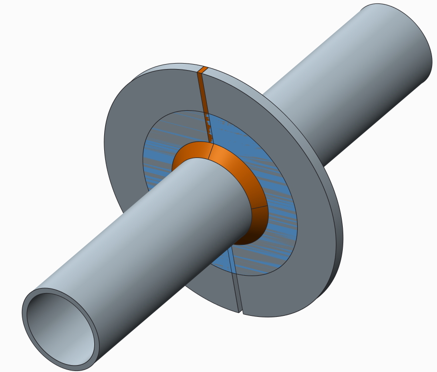

2. You could create a surface that represents the face of the two welded disks and then reference it for the fillet weld between the welded plate and the tube. Then just hide surfaces in the layer menu and save the layer status.

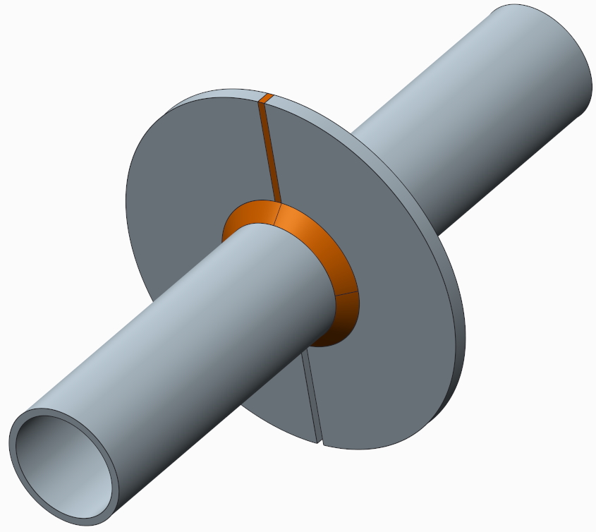

Thanks for that, works a treat!
Took me a while to get the surface to look tidy, after I put the weld on the drawing showed a ring so I created a new layer and hid that.
