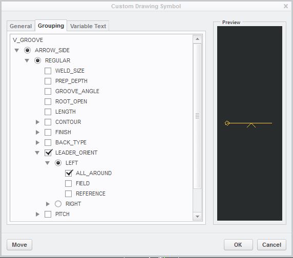

Is there a way to put welding symbols in an engineering drawing in Creo 3.0? Specifically, I just want to define a groove weld on a pipe all the way around.

Actually, I just figured it out. In the 'Annotate' tab I selected 'Symbol' -> Custom Symbol -> Browse -> Program Files -> PTC -> Creo 3.0 -> M110 -> Common Files -> Symbols -> library_syms -> weldsymlib

Under Annotate Tab select symbol > system syms > weldsymlib > ansi_weld > simple then select "v_groove.sym" file.  Prior to placing the symbol go to "Grouping" tab and drill down into the option "Arrow_Side" until you see "Leader _Orient"  Depending on what symbol direction you placed, Left/Right, select "ALL_AROUND"
