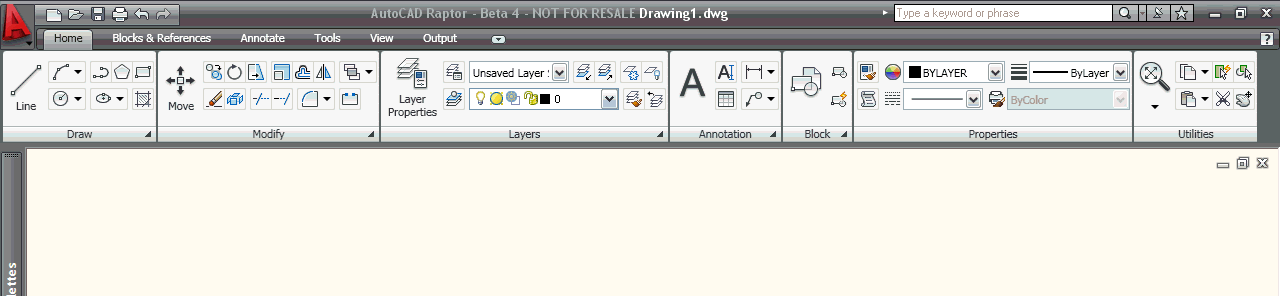

    Anybody know how the Autocad community responded to their ribbon bar change?
    [cid:image001.gif@01CAD64D.A9212CF0]

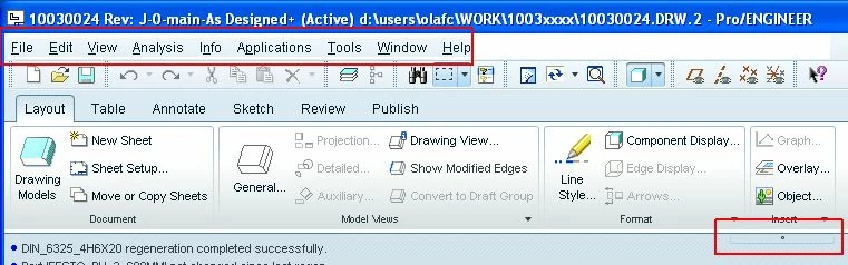

    One of *my* biggest complaints for now is about the position of the
    standard File, Edit, View menu's.
    With the Ribbon UI they were moved to the top *right* side of the
    screen. They were obviously moved over there to save valuable screen
    space.
    But that is not intuitive at all. I know of *no* other Windows
    application that has these commands in an other corner than the top
    *left* corner.
    Also some of these commands will be only available in a flyout menu on
    smaller screen resolutions:
    I was also told that these standard menu's will be gone in future

    I think that PTC should keep on concentrating on an multi driven User
    Interface with
    General menu's: File, Edit, etc (with all the commands and
    additional commands provided by toolkit applications)
    These should be placed in the top left corner.
    Toolbars (with the most important commands)
    Ribbon UI (with all the commands)
    Including a lot of the optimizations suggested by the users.
    Like a quick Ribbon UI close/open button.
    Dashboards
    Mapkeys
    To underline my idea. Here a Photoshopped version of the WF5 Drawing UI
    as I would prefer it with the standard menu's in the top left corner and
    a quick Ribbon UI toggle button.:
