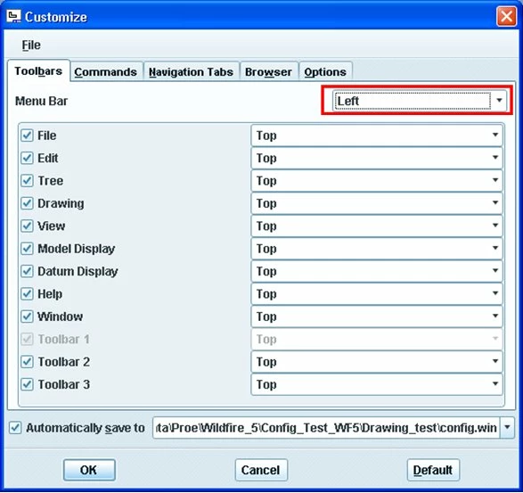

    Olaf,
    You can set up the menu the way you depict. The first thing to do is go to the Toolbars tab in the Customize dialog box. In the upper right corner is a pulldown that lets you specify Left or Right for the menu bar. I just found that yesterday. It is also possible to arrange your toolbars below the menus as shown in one of the attached pictures. Of course now it's starting to take up a lot of vertical space.

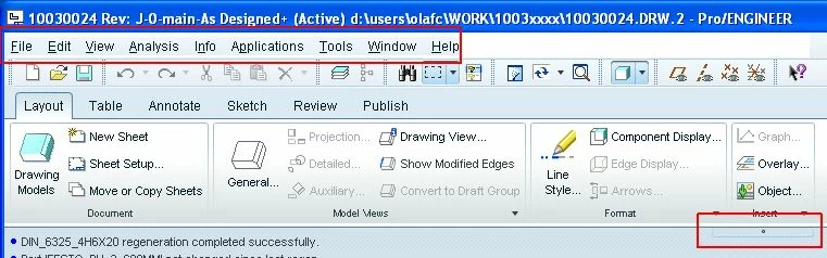

    Hi Raphael,
    Thanks a lot for joining this discussion. This shows how dedicated PTC
    is at listening to their customers.
    One of *my* biggest complaints for now is about the position of the
    standard File, Edit, View menu's.
    With the Ribbon UI they were moved to the top *right* side of the
    screen. They were obviously moved over there to save valuable screen
    space.
    But that is not intuitive at all. I know of *no* other Windows
    application that has these commands in an other corner than the top
    *left* corner.
    Also some of these commands will be only available in a flyout menu on
    smaller screen resolutions:
    I was also told that these standard menu's will be gone in future
    releases of ProE anyway.
    With that I have to disagree completely. The fact that Microsoft decided
    they didn't need them anymore in Office should not be the reason to
    remove them from Pro/E. The idea behind the Ribbon Interface was to
    simplify the command structure to a more taks based structure where you
    just simply follow the task in the tab's from left to right and then
    your finished. But working with 3D and 2D CAD is way more complex than
    working with Office documents.
    I think that PTC should keep on concentrating on an multi driven User
    Interface with
    General menu's: File, Edit, etc (with all the commands and
    additional commands provided by toolkit applications)
    These should be placed in the top left corner.
    Toolbars (with the most important commands)
    Ribbon UI (with all the commands)
    Including a lot of the optimizations suggested by the users.
    Like a quick Ribbon UI close/open button.
    Dashboards
    Mapkeys
    To underline my idea. Here a Photoshopped version of the WF5 Drawing UI
    as I would prefer it with the standard menu's in the top left corner and
    a quick Ribbon UI toggle button.:

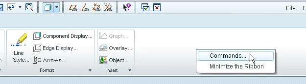

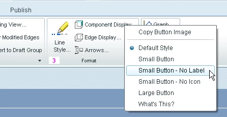

    Hi Jim,
    The buttons for commands in the Ribbon can be customized. You can either
    select Tools > Customize Screen or just select Commands... from the menu
    if you right-click on the Ribbon.
    If you right-click on an individual command, you have options to display
    the button with just an icon (no label), just the label (no icon), or
    even make it a large button.
    This should get saved with your config.win settings and stay that way
    next time you start Pro/E.
    I hope this helps.

    Hi Olaf,
    Thanks for the feedback. Wildfire 5.0 does allow for the menu bar to be
    positioned to the left.
    Go to the Toolbars tab of the Customize dialog (Tools > Customize
    Screen) and you can select the pull-down to position the menu bar on the
    left.
    While it does break with convention, we positioned it on the right by
    default because the pull-down menus tended to overlap and get in the way
    of the ribbon tabs. However, because we recognized that some users would
    rather keep it in its familiar location, we allow the option of
    customizing its location.

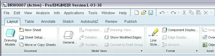

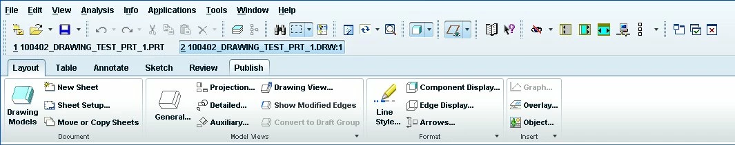

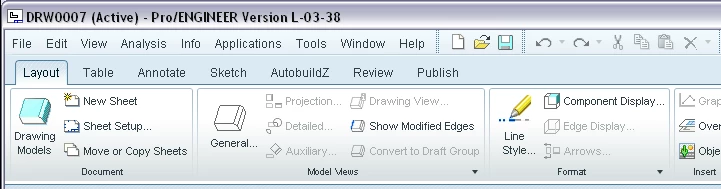

    April 8, 2010
    In Reply to Ken Nunn:
    I absolutely agree with Olaf .
    cid:235424905@08042010-1711
    I would be significantly more productive with this as it offers the best of
    all worlds.
    Ken...I found how to move the menubar to the left side of the screen, but how did you get the toolbar to go between the menubar and the ribbon?
    Jason
