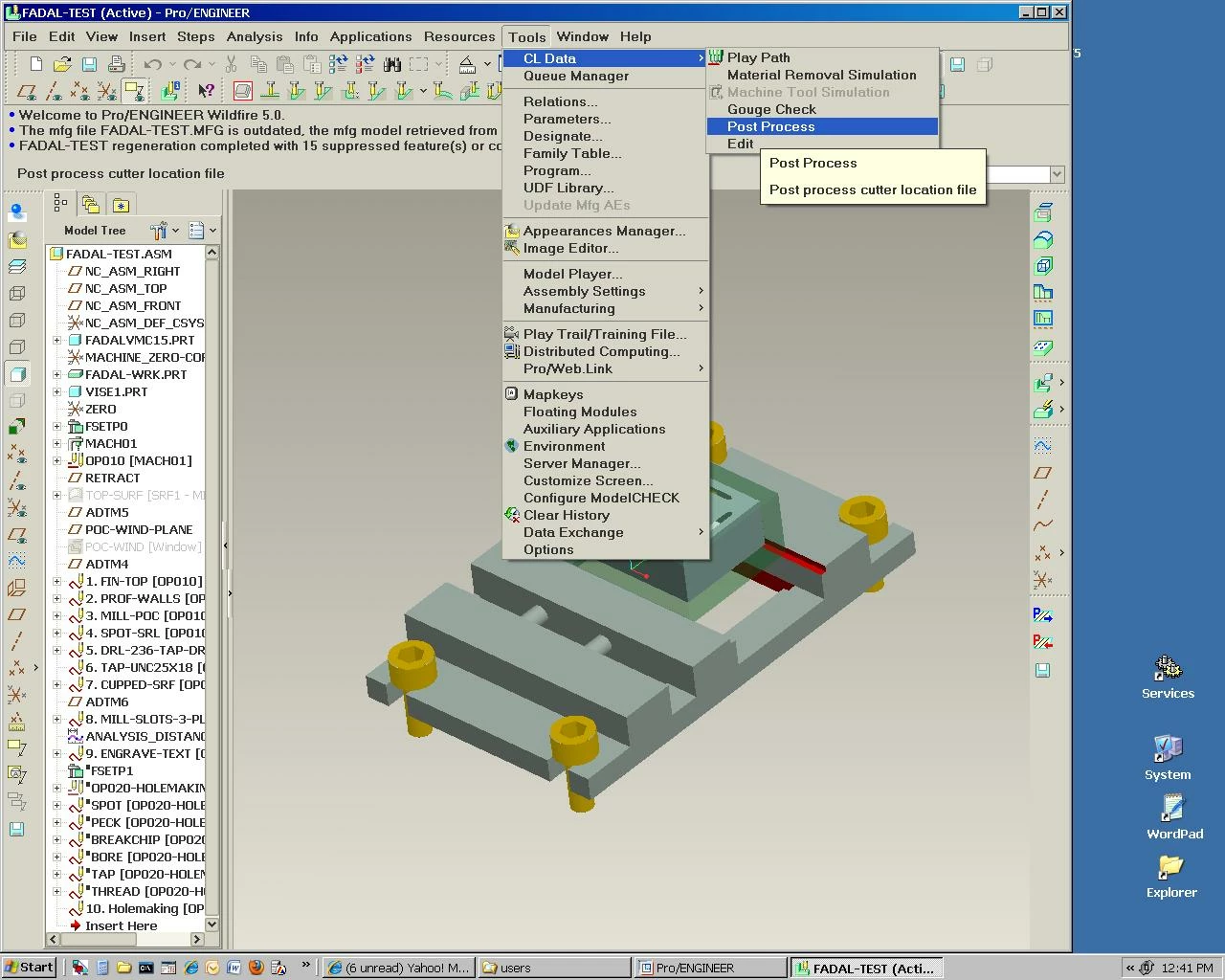

I am going thru the migration of WF4 to WF5 and now I am getting into the
Mfg side and saw that the menu manager is gone. Does anybody know the
correct way to post g code out? The way I am stumbling on to this is I
select the operation and right click to play path. After I am in the play
path I select File save the .ncl file. Then I go to Tools>CLdata>Post
process. Is this the correct way? It seems a hassle if this is the case. If
I am getting ready to post out code for a mould plate I will be sitting
waiting for the player to pull up the whole operation on screen then save
and then post it. I am liking the no menu manager look but am stumbling with
the new layout.
