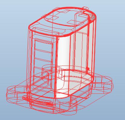

Which component is selected here? (white or blue?)
Has anyone else noticed that in WF5 if you highlight or select a component in an assembly it highlights all the hidden entities? This is a real nuisance in top down design with components that have Ext. Copy Geoms of other components. When you select or preselect the component it is hard to tell which component you have selected. Pre-WF5 it does not do this, only the shown geometry is highlighted.
Any fixes out there?

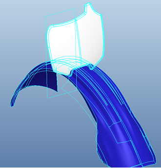

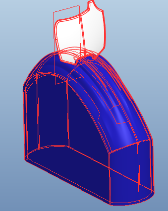

I think you selected the White part.
Here is my part.
Which one do you think I selected: the white one or the one that is not in this assembly?
